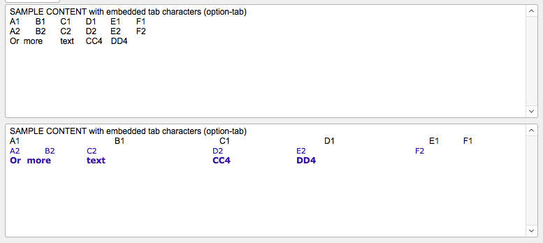

On 6/8/2017 at 0:46 PM, vanderark1 said:
I understand how to adjust Tabs, alignment, etc using FM>>Line Spacing>>Tabs.  However, that sticks to the field regardless of the data it is showing.
Not necessarily. You can leave the field unformatted; and use simple templates and substitutions to apply different tab sets.
You can even apply different tab sets to each line.
See attached rudimentary example.
ColumnFormats.fmp12
This is an interesting technique - but it will not adapt itself to data. You can prepare various field widths in advance, but if one of the values exceeds its field's allowed width, that row will be misaligned. A Filemaker's field will wrap the text to its width (it can do even more in Preview/Print); an HTML table cell will try to expand to accommodate the largest value in the column, and wrap the text if it cannot. Even when preparing a fixed-width file export, we chop off the excess characters.
