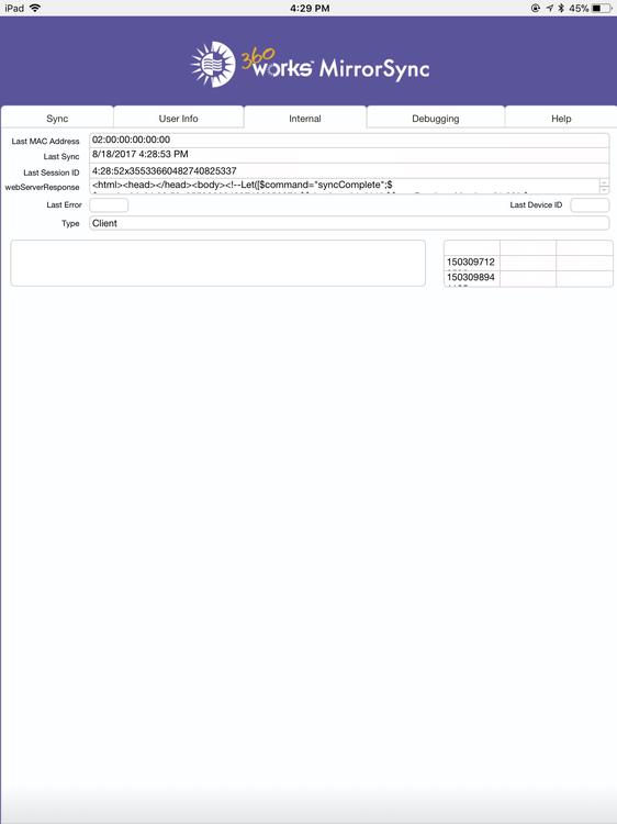

I had gotten this a few times and the script lans on the internal tab of the MS layout.
I don't understand the issue, could you provide more explanation?
after first sync and everything worked fine. I made a small change and updated the version number and then synced again got the prompt to update but thats when i got the message
