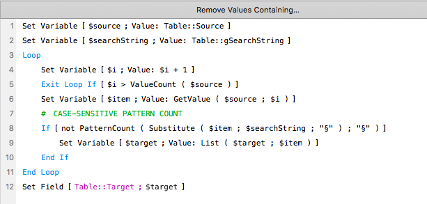

See if something like this could work for you:
RemoveValues.fmp12
Yes, exactly what I need, thank you very much to both for the help.

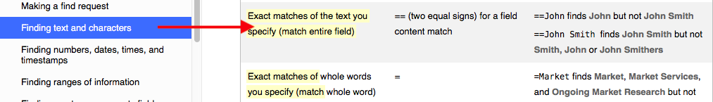

Hi Lee,
How can I use the == signs so the script substitutes the exact value in gSearchString?
5a7c722d8bc61_ScreenShot2018-02-08at11_51_13AM.png.74a7e2e646d54548374ea850a54fbdf3.png
Hi Gilbert,
  1. The script furnished by comment was written to isolate the records that started with a specific pattern in front of the numbers.
  2. You don't need a script for a simple find such as the number 2 in a number fields, as long as it is the only number.
  3. By chance are these the remaining numbers that are in your original field?
  4. Your find request in a number field for 2, should not be returning 22.
Perhaps if you should attached a copy of the file, so we can be sure we provide a script you can plug in to your file.
