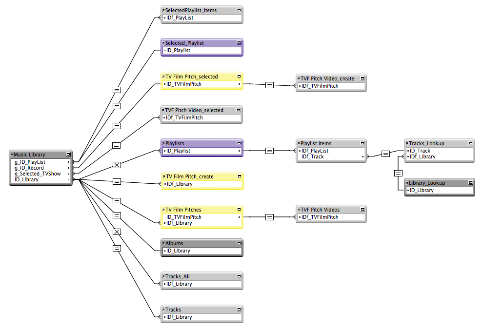

February 1, 20188 yr Author Thanks for the cleaned up graph, Bruce. Now I'm assuming this is purely cosmetic and the spare tire is still in the back seat, steering wheel attached to left fender, etc? By the way, the table occurrences in the image is actually a file from FM but for my needs, it seemed rather limited and thought to expand. If you're not understanding my vision then I must not be explaining myself properly... although I feel I couldn't have been more clearer. I may not know all the FM lingo but I'm not quite sure how to better explain that "TV & Film Pitch" is a sub-category of "Song Info".
February 2, 20188 yr Hi Christoph, The FM Forums welcomes members of all skill levels. The only requirement being that they have familiarize themselves with the FileMaker basics. I opened your file, and the first thing I did was to organize the Relationship Graph. The Relationship Graph is not a ERD, however, it does give you insight to the file structure. The ERD should be setup when you are starting a new solution. I would recommend that you study what an ERD does, and how it fits into developing a databases. If you are not sure what an Entity Relationship Diagram (ERD) does, do a search for either ERD or Entity Relationship Diagram. This is just one of the hits that a Google Search found. https://www.lucidchart.com/pages/er-diagrams Here is a free ERD tool that is available at https://www.draw.io However, you can do one using a pen and paper. There is a FREE training class being provided by ISO FileMaker Magazine https://www.youtube.com/channel/UC92MpDPgdr-xEn3JRUAmZOQ I wish that someone had provided classes like this when I first started to develop in FileMaker, There are currently 4 Areas being covered by Matt Petrowsky so far, Environment, Fields and Calculations, Data Structures , and Layout Mode and Design, The Data Structure Lessons would help you a lot with Relationship Graph, He has spent a lot of time covering this section. There are other training sites that offer training, I can send you a list of them if you want. HTH Lee
February 2, 20188 yr 20 hours ago, Christoph said: Thanks for the cleaned up graph, Bruce. Now I'm assuming this is purely cosmetic and the spare tire is still in the back seat, steering wheel attached to left fender, etc? By the way, the table occurrences in the image is actually a file from FM but for my needs, it seemed rather limited and thought to expand. If you're not understanding my vision then I must not be explaining myself properly... although I feel I couldn't have been more clearer. I may not know all the FM lingo but I'm not quite sure how to better explain that "TV & Film Pitch" is a sub-category of "Song Info". If I get what you are trying to do: 1. You have to create a new record in order to get a new row in the portal. You many need to split the info in the portal out into it's own table. But I would need a little more info to understand exactly what you are trying to do with that. 2. To select a portal row and have the details show on the layout of the local record, you need some kind of relationship to get the field to show that record's data. Or as a master detail, move the current record to the one you clicked on. We definitely want to help, so don't give up yet.

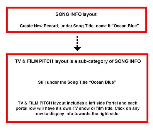

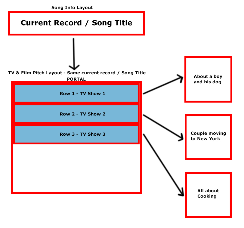

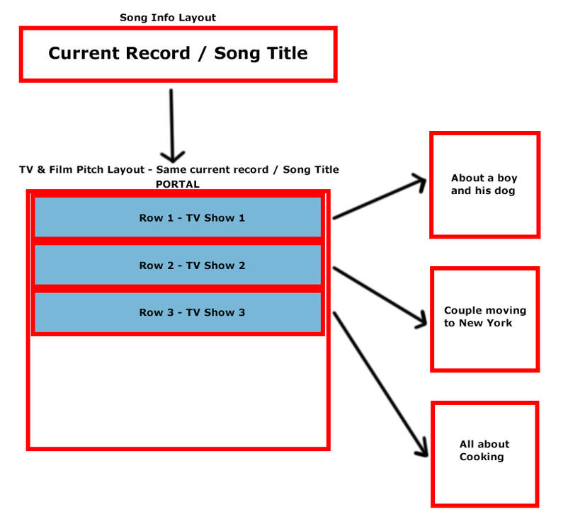

February 2, 20188 yr Author 3 hours ago, Josh Ormond said: If I get what you are trying to do: 1. You have to create a new record in order to get a new row in the portal. You many need to split the info in the portal out into it's own table. But I would need a little more info to understand exactly what you are trying to do with that. 2. To select a portal row and have the details show on the layout of the local record, you need some kind of relationship to get the field to show that record's data. Or as a master detail, move the current record to the one you clicked on. We definitely want to help, so don't give up yet. Hi Josh, Thank you for looking into this as well A few days ago, I was able to get my solution to sort of work with creating a new record, which gave me a new portal row but when I did that, it took me away from the current record (or in this case, Song Title). Is there any other way around it where when I create a new portal row, I am still on the same record (Song Title)? Thx. Cheers!
February 2, 20188 yr Author 43 minutes ago, Josh Ormond said: Define "took me away from the current record". Hi Josh, Thanks for the quick response. Sometimes I’m better explaining with a diagram because of my limited knowledge but in the image, this is exactly what I’d like FM to do. The current record (or song title) in the “Song Info layout” is the same current song title in the “TV & Film Pitch layout”. They work together. I can pitch a song to multiple TV shows, without having to create a new record, as I have designed in the enclosed diagram. I know I can do this another way. For example, create a single layout, add the Song Title field and other fields pertaining to the song. Then, I include a portal (on the same layout), add the TV Show title and other fields, and when in Browse mode, when I add a new TV show title, it’ll create a new portal row for another TV show and all its data but I'd rather not have it this way. Does this make sense? Thx!

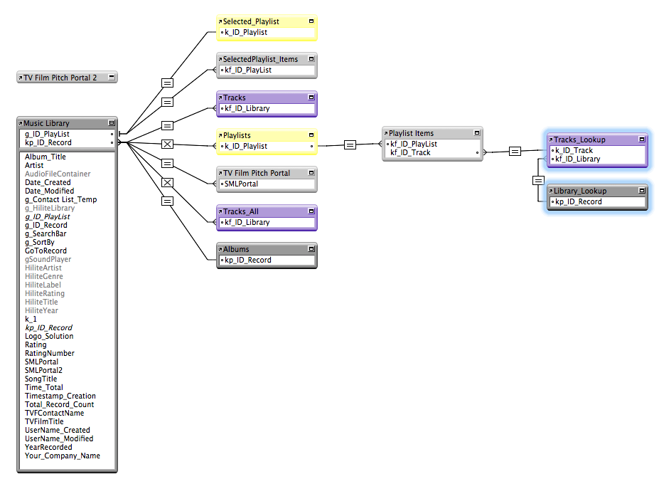

February 3, 20188 yr See if this is close. I added a couple relationships. one to add new TV SHOWS or FILM TITLES to the portal. one to select the show or film in the portal...which allows the fields on the right to display data from portal ( and show the correct data ). I added a step to the Highlight script. It sets the global field, that links the current record to the one you clicked on in the portal. Which also allows the you to display the data from the portal in the fields on the right. Dig into it. Let us know if you have any questions. As Bruce had mentioned, it would be wise to make a copy...then clean out stuff you are not using. There is a script trigger in the portal that was not linked to an actual script. Some relationships are not used ( at least in this file ) etc. Test File Demo.fmp12
February 3, 20188 yr Author Josh!!! You did it!! Woot woot!! (doing the happy dance) Thank you soooo much! Beautiful work!! I knew this could be done and later this evening, I will try to follow your work to incorporate into the actual FM file. Once again, many thanks! Cheers!
February 3, 20188 yr Author 57 minutes ago, Josh Ormond said: Good to hear. Post back if you have any questions about how it works. You got it, Josh and again, thank you. Works like a charm
February 3, 20188 yr Author Hi Josh, I thought I'd work the Pitch layout a little more by adding another portal into a slide control. When you have a moment, could you please have a look at the enclosed file again and see where I went wrong? When in the TV & Film Pitch Layout, and you go between the portal rows "Mash" and "Big Show 2", the Notes field follows correctly... but when you go to the next slide control layout, the portal/portal rows don't seem to work properly when you go between the 2 show titles. I've tried to connect table occurrences but still a no go. Thanks a mill! Test File Demo 2.fmp12
February 3, 20188 yr Your creation point is different. Because the Film Pitch Notes belong to the Film Title...you have to create it using a relationship to that table. Then you can use another global field to select that film to be the basis for which records you want to see. Test File Demo 2.fmp12 Note, that the Film Pitch Notes will be created being related to the film you have selected in the Film Pitch Portal.
February 3, 20188 yr May I suggest that you work with this version going forward. It clarifies key field names, reorganizes the graph, and eliminates "portal" from any table or relationship names. The TO may be used in a portal. But labeling the TO as someThing_someThingPortal hides actual relational concepts. Test File DemoJOBR.fmp12 Edited February 3, 20188 yr by BruceR update graph image
