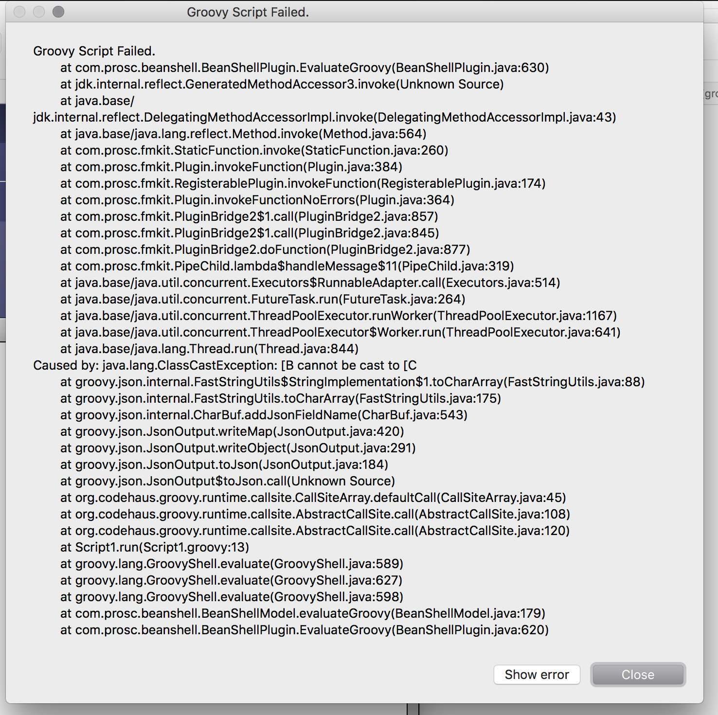

JSON functions seem to fail
import groovy.json.JsonOutput
class Person { String name }
def result = JsonOutput.toJson(new Person(name: 'John'))
This 'should just work' - this is Groovy 2.4.0
Mac 10.12.6
Scriptmaster 5.07 up to 5.1
all fail with this
Ideas on a postcard please...I
BUT it does work all the way back in 4.42 and FM15
Edited by john renfrew
Hi John,
this was a compatibility issue in combination with Java 9 and is fixed since Groovy 2.4.6. You ran into it since Scriptmaster on OSX ships with Java 9 now...
System.setProperty("groovy.json.faststringutils.disable", trueshould work, but I have no way to test it, as I'm on Windows (Java 8 ) at the moment.
For reference see: https://issues.apache.org/jira/browse/GROOVY-7716
Edited by paja
Almost certainly the issue
line might be ==
System.properties['groovy.json.faststringutils.disable'] = true
it still doesn't fix the problem as it thinks it has no way to convert a [B to a [C

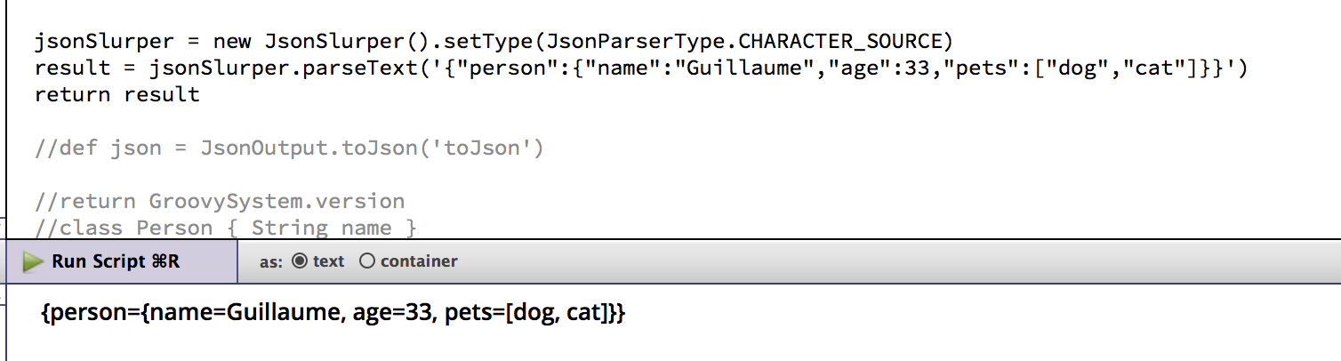

John,
I saw it in API docs, but any try to change JsonParserType fails (I can't change it to any other). I tried all solutions found in web.
Marek
works just fine here....

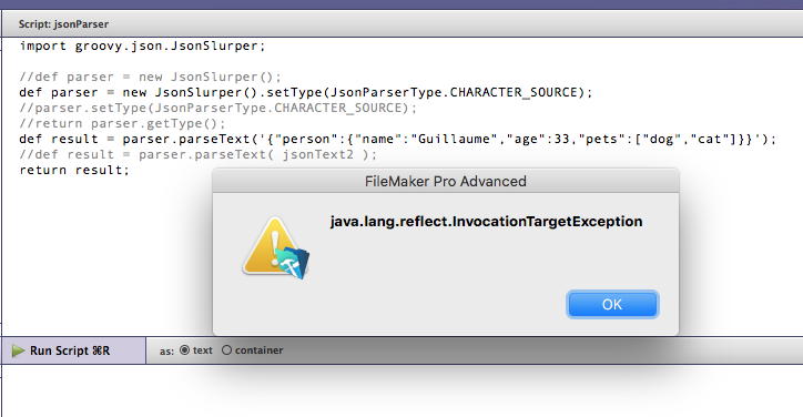

But code:
import groovy.json.JsonSlurper;
parser = new JsonSlurper().setType(JsonParserType.CHARACTER_SOURCE);
result = parser.parseText('{"person":{"name":"Guillaume","age":33,"pets":["dog","cat"]}}');
return result;
throws error:
java.lang.reflect.InvocationTargetException
like in attached picture.
The same error with 1-st code (without setType) throws when I try to parse more complicated Json object consists from over 2000 of arrays. The same Json limited to few arrays works OK. This is the reason to try setType, but as you see without success. If you like I can send you by mail 2 files which I'm speaking about (complicated and simplified).
