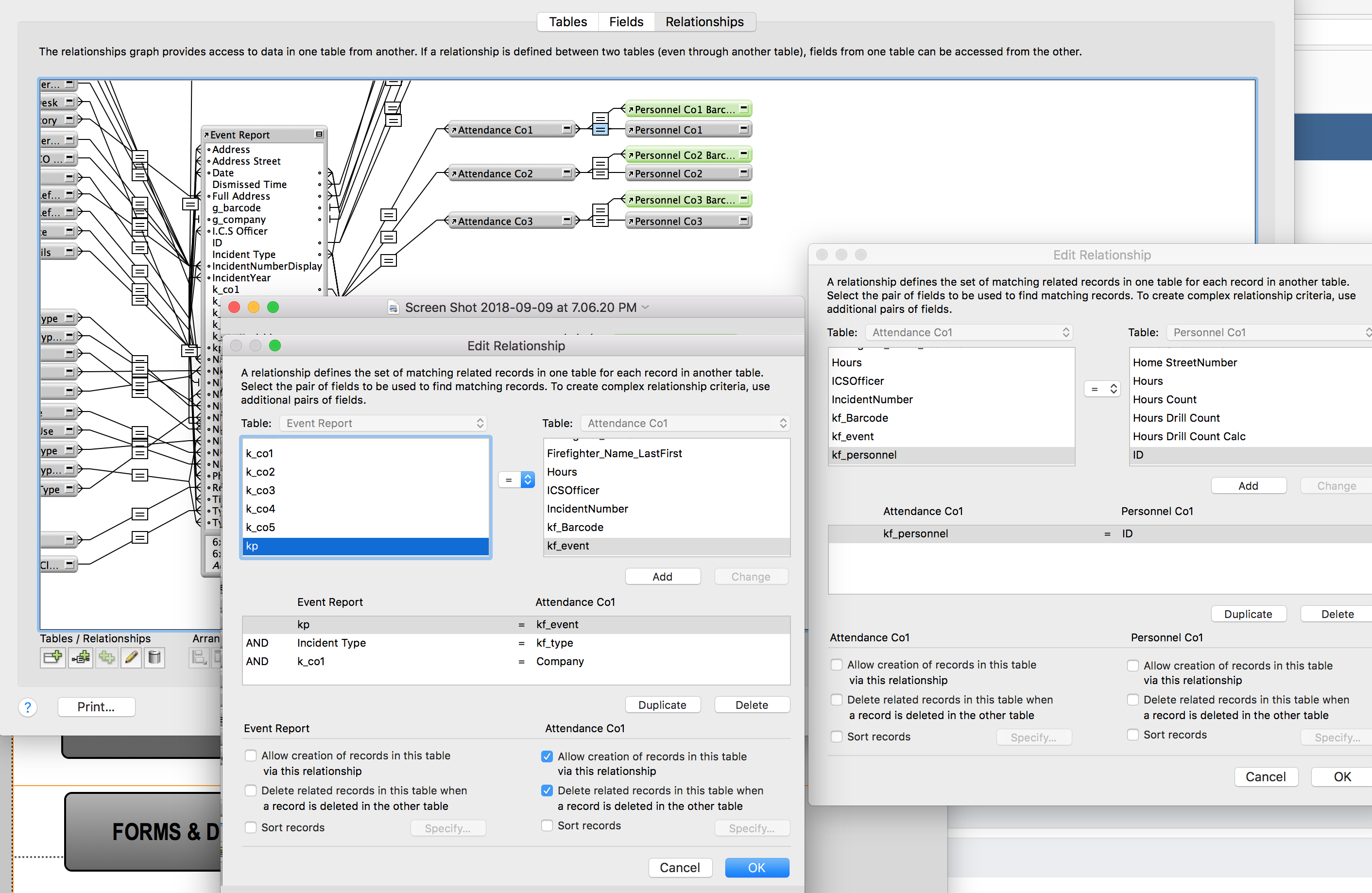

I have an Event table (Fire Incidents) and related to the ID of the event you can create attendance records in the attendance table for the members responding to the fire emergency.  I do the attendance adding using a portal on the event record and add the members by capturing their Personnel record ID and then setting the last row of the attendance portal using their personnel record ID and the event ID.  That has been working great and there is no issues there.   I wanted to add a new validation that looks to see if that Personnel record ID AND Event Record ID do not exist as an attendance record, before it allows the user to add the attendance.
I'm not sure what I should show here, relationship graph, or something else to help understand what my file looks like.   Let me know if I should send any additional info.

That's a great idea.   I created that field and tried it out.   What would be a good way to deal with all of the error messages that come up when a duplicate record is created.  I have a dialog box pop up when the validation fails but then a few more Revert or Cancel dialog boxes come up and then it still allows a user to ultimately create a duplicate record.
Thanks,  Chris
