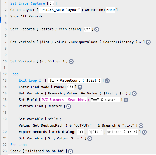

February 14, 20197 yr Author Thanks Ocean West. I have copied-and-pasted your code and changed what I could see needed changing. (I couldn't see how to copy the amended Script's text, so I attach a screenshot of it). I created a folder called OUTPUT on my desktop, which is where I think the file is supposed to be written. The script Runs (very quickly!!) with no error messages, and gets to the end where it speaks "Finished ha ha ha", but there is no file inside the OUTPUT folder. Can you help me with this???
February 14, 20197 yr Since you are on FM 16 there isn't an option to 'create" directories - so you will have to manually make sure there is a folder called OUTPUT on the desktop otherwise it will fail. If you need to stay in FM16 you can use BaseElements Plugin or an AppleScript to create a the OUTPUT directory. Also on FM16 you don't have the UniqueValues function, a custom function may be required to obtain a unique list of values ( line 7 is commented out ) Calculation for lIne 7: ExecuteSQL ( "SELECT Distinct SearchKey from PVC_Banners" ; "" ; "" )

February 14, 20197 yr Author I am still getting no file written into OUTPUT folder. Shouldn't "Set Error Capture [On]" cause an error message if a variable isn't set or a Search fails? Also, I have tried changing the new Line 9 as attached, hoping that would set $list to LH_101 (which is definitely one of the values in the field) in order to see if that worked, but it still didn't work. ================================================================= =============================================
