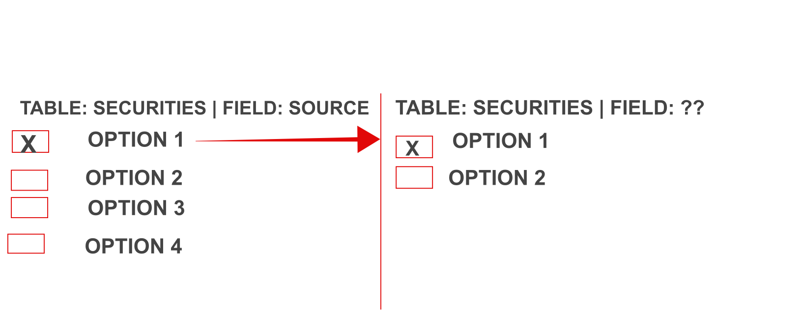

My layout "Securities" is from TABLE: SECURITIES and uses FIELD: SOURCE / checkbox with 10 values. Second layout is also from TABLE: SECURITIES where I would like to have  only 2 of the values showing from FIELD: SOURCE (one or both may show check/yes). Tried to show example in image below (not using the 10 values). If I create another field on the second layout, how do I call the values from FIELD: SOURCE for that layout?

A field formatted as a checkbox set displays a checkbox for each value in the associated value list. If you want another instance of the same field to display another set of checkboxes, you need to associate that instance with another value list. The two instances can be on different layouts or on the same layout.
Note that checking/unchecking a checkbox affects only the value displayed alongside that checkbox. In your example, if the user has checked OPTION 1 and OPTION 4, then moved to the other layout, they will see only OPTION 1 being checked. If they uncheck it, the field will still contain the value of OPTION 4.

I am not aware of another method. What is your objection to the method I suggested? It's quite simple: define a new value list that contains only OPTION 1 and OPTION 2 and format the 2nd instance of the field using the new value list.

I am not sure I understand what you mean by that. There is only one field. It can be displayed in different ways, but its underlying content is always the same.

As I said earlier, a field formatted as a checkbox set displays a checkbox for each value in the associated value list. The definition of a value list is part of the file's schema. If you clone the file, the schema will not change. If you want the clone to display a different set of checkboxes, you must modify the definition of the value list.

I am afraid I have no idea what is the actual purpose of this exercise. The solution to the problem as presented is very simple: have a look at the attached file.
