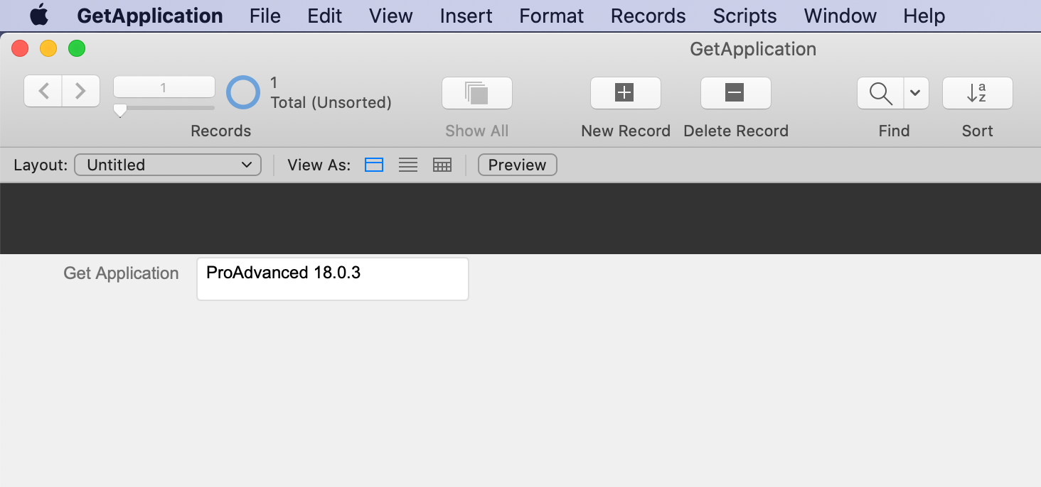

So then for process of elimination, I created a new database with only one field. A calculation field with a global that was just "Get(ApplicationVersion)".
In browse mode it displays: "ProAdvanced 18.0.3" when running FileMaker. This is correct.
When I create a runtime of this exact simple solution, again, launching the runtime does not display "Runtime" now but rather still displays "ProAdvanced 18.0.3" even when running the runtime.
I've attached a screen shot of the runtime, and the simple/basic solution file just for reference.

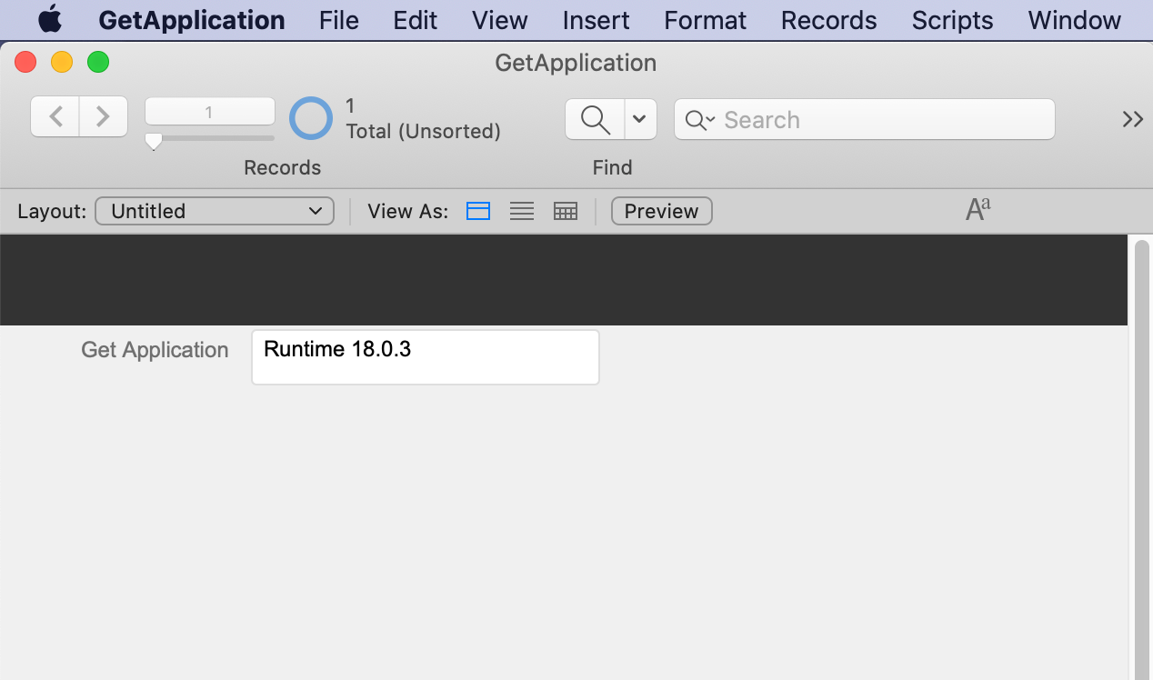

Your calculation field is global, therefore stored. Therefore it keeps the value it had when evaluated for the first time. To have a valid test, you must make the field unstored. (And strictly speaking, the result type should be Text.)
Note also that the result of Get(ApplicationVersion) will never be "Runtime".  It will be something like "Runtime 18.0.3" (or similar, untested). So if your script is testing for Get(ApplicationVersion) = "Runtime"  it will never get a true result.
You are awesome. Like, really awesome!
Your simple explanation fixed my problem entirely. Thank you!
I redid the calculation field as you mentioned and it worked like a charm. I read the manual for this and it didn't mention any of that. So I sincerely thank you, and I know runtimes are going the way of the dodo bird, but hopefully my stupidity will help someone down the road who finds this question via google, because I searched and didn't find anything. :)
