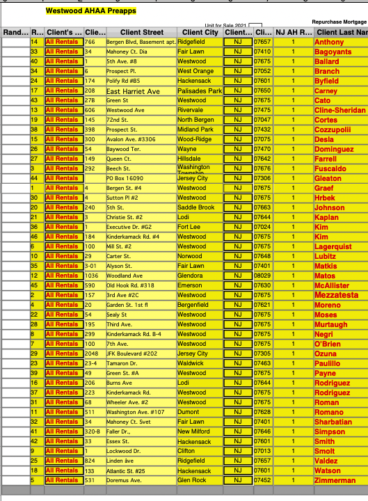

2022-12-13 35 Jeff preapplicants by last name.pdf
Oh, I'd be fine if the list was less than 1 page long.  I could just do a screen shot.  Hey!  Wait.  I can zoom out and make the list small enough to fit on one page.  Yes!  That does it.  Thanks for the inspiration.
What do you see in Preview mode?
in Preview mode I see all of the records-being-browsed when in list view as above.  But when I try printing records-being-browsed from preview mode I get the same single record.
