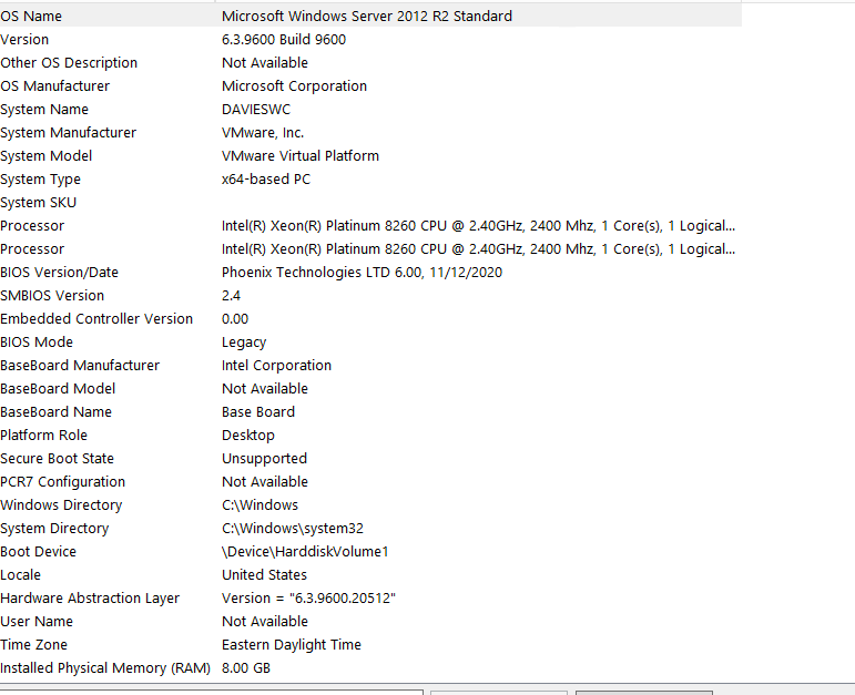

I'm sure you would agree, based on what I have just pulled from my console (see attached), that compatibility must in fact be an issue, if not the issue? My FM Server version is 19.3.2.203. The OS is Microsoft Windows Server 2012 R2 Standard, which is, I gather, very old. I'm not sure whether the current hardware will even support what Claris page appears to list as the minimum FM Server requirement: Windows Server 2019 Datacenter (with Desktop Experience). So it may end up being both a hardware and OS software issue.
I will raise the incompatibility issue with my university's IT support.
Note that to unfreeze the server today,  IT support said they doubled my memory and CPU. Is it possible that space is also part of the problems I have been having? I had issues in the spring that manifested differently, and IT bumped the specs up back then. So today is the second bump. From a May email from my IT support in response to problems connecting to my database:  "the server is running on 1 vCPU and 4 GB RAM which is too low in my opinion. I think the minimum should be 2 vCPU and 6 GB RAM.1 vCPU and 4 GB RAM which is too low in my opinion. I think the minimum should be 2 vCPU and 6 GB RAM." It appears now that I am at 8 GB. My FM database is 30.4 MB. Because I can no longer test SMTP-dependent scripts from the client but must do so from the server, I currently host two similarly sized versions of the database on FM Server at the same time. I don't know how much RAM I must have for each MB of database. FM Server itself (about 55 MB?) will of course eat up a lot of the CPU's memory.
Let me know if you can whether you think memory and CPU were and are still part of the issue, or whether I should should be focusing on compatibility. (I haven't yet had a chance to test whether the problem with PSOS has recurred with the doubling of memory and CPU.)

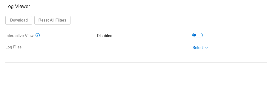

The viewer:

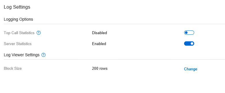

The settings:
Should I be adjusting the settings? (I am not that conversant with the FM server side.)

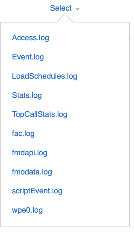

Click Select and choose a log to view and download you may need to view it in an editor or it is easiest to drag it on to FM icon to create a database so you can sort and search as needed. Typically the Event.log or ScriptErrors.log - see below

as far as latest support of OS yes I am baffled that they would continue with 2012 support , be aware usually there're is an increase in license support

I must correct something I said earlier:
On 8/9/2023 at 12:21 AM, comment said:
The first thing I would check is the server's OS compatibility with your version of FMS.
I have now noticed that the version you are using is not fully updated. In fact, no less than 10(!) updates were released after your current version of 19.3.2.
So actually the first thing I would do is update the FMS to 19.6.3. And then I would ask for the server's OS to be upgraded to one of the versions that were tested by Claris and declared compatible with the running version of FMS.
