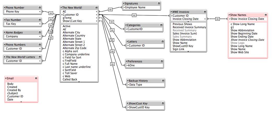

I am working on a solution that invoices customers for booth rentals at yearly trade shows. Many customers attend the same shows year after year. It consists of these linked files:
  • Customers are in a table named "The New World!" (note the exclamation point) in a file named "The New World"
  • Shows are in a table named "Show Names" in the file named "The New World"
  • Invoices are in a table named "WWE Invoices" in a file named "WWE Invoices"
Here are the relationships:

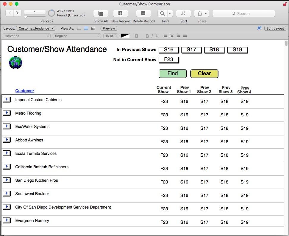

I have successfully created a layout that lets the user choose any four prior shows and an upcoming show using a value list of show abbreviations from the WWE Invoices file (S19= Spring '19, F23=Fall '23, etc.). This works to find all customers who have attended any one of the prior chosen shows but not yet signed up for the upcoming show.

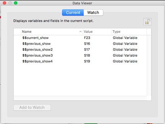

When they select the shows they are creating these global variables in the background:
The script then works like this:

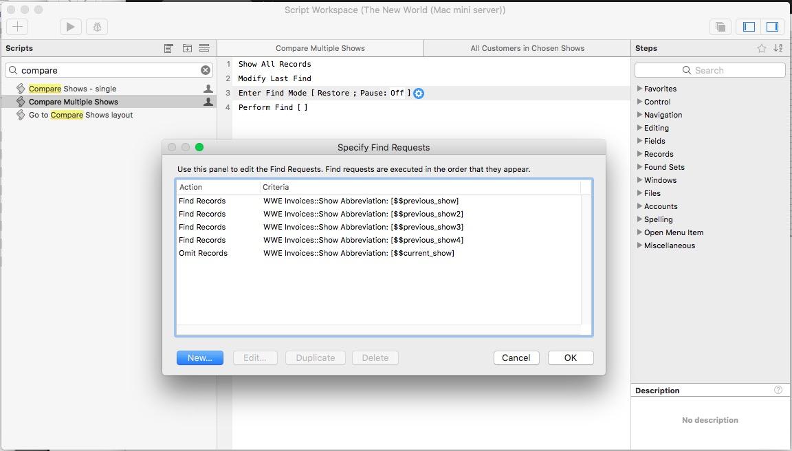

OK thanks for that tip, it now works! See this:
Edited by macmasterservices
Watch out for the last Set Field step: it's performed in Browse mode, which is not what you want to do when finding records. If you're using stored find requests, then all you need is the Constrain Found Set step. Like many other developers, I usually prefer to do:
Enter Find Mode [ ]
Set Field [ Invoices::ShowAbbreviation; $$currentShow ]
Omit Record
Constrain Found Set [ ]
because then you can easily see what the script does, without having to delve into the stored requests details.
