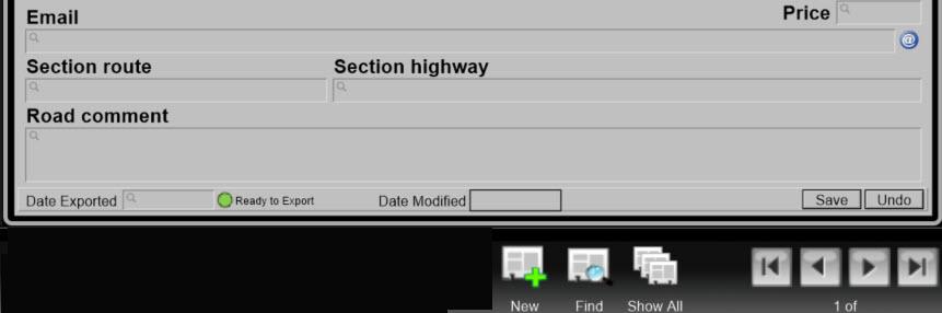

Yes, they are the only date fields on each record.  There is a date modified field (image attached) and a date exported field.  Records are modified as information comes to hand, and I wanted to find all records that hadn't been modified in the last 6 to 12 months.  I've used the range fields .. and the less than < fields but none return any recogisable data that would give me what I need.  I'm using Find ... right clicking in the field to bring up operators then using one of the selections ie. < .. etc
