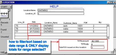

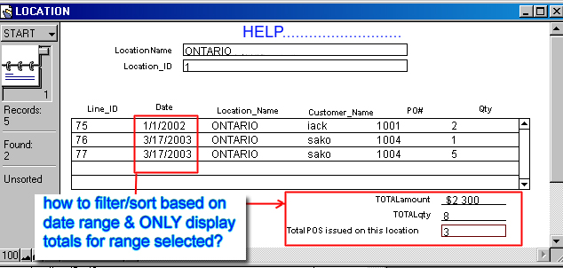

please take a look at the image attached...it will (hopefully) be more direct than me trying to explain the problem
of course, this is having CDML in mind
in other words what is the input tag for the filed in Portal:

I've just had another look at your image. You may find that working directly on the related file will improve your chance of success.
All the best.
Garry
Hi Garry!
I tryed but with CDML in mind I can not sort properly....the totals get changed since the file with the portal on it contains 5 records (each record - different Location...."date range" and "Location" are parameters from the Search)...
does this make sense?
date range per each Location(record)which has its own Totals!?
What do you suggest?
thank you sir

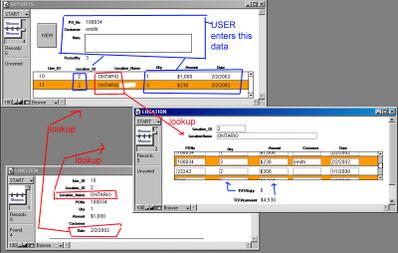

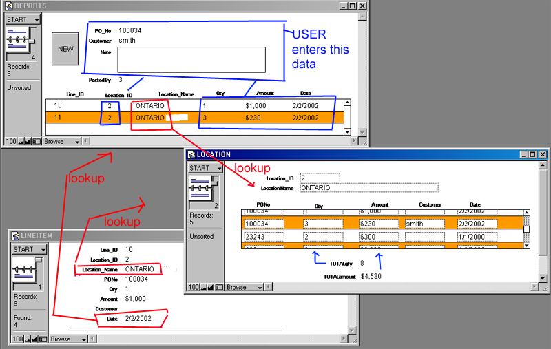

PLEASE take a look at the image attached so we are on the same page!
thanx
sorry for editing post so many times...but the more I write the more questions I have (the better understanding hopefully ):
"if not why would I need the Location.fp5 file at all? "
what I meant is that I can do these Total calcualations in LINEITEM.fp5 file and the LocationName/ID can be easily inserted in LINEITEM wihout lookup.....For results I am now sorting the lineitem.fp5 file???
I mean....at the bottom of it all I am back to only needing/sorting 1 file (lineitem.fp5)...therefor...WHY NOT just keep the LINEITEM.fp5 file and forget all the relationships/lookups?!
this is not an "invoice-ing" system it is only a "total-ing" system!
so....if am I am doing all the searching/sorting on the single file in order to avoid portals....well... frown.gif I am back to @#$%@ post about [FMP-IF...InlineActions that lead to nothing and eventially to creation of this post..... frown.gif aghhhhhhhh my head hurts!!!!!!!!!!!!!!
hurry Oby-One you'r my only hope!:
The "Locations.fp5" file is a related file with a relationship based on "location_id". Hence, you do not need to store both the "location_id" and the "locationname" in the "lineitem.fp5" file.
However, if the Locations will not vary, you may-as-well have them as a Valuelist and store them as data. You will not need the "location_id" field in this case.
The "reports.fp5" is new to me. I guess that the "lineitem.fp5" file contains the line-items for each Report.
I assume the Aim of the web-page is to show sales by Location for Date periods. You can use summary fields for some of these reports.

Here is the basic Format file which summarises the Locations:
<html>
<head>
	<title>Leb Results All</title>
	<meta name="generator" content="BBEdit 7.0.3">
</head>
<body><script>var tot_qty = 0; var loc_total = 0; var curr_loc = "Location";
[FMP-Record]
if (curr_loc == "[FMP-Field:locations::location_name]")
	loc_total += [FMP-Field:qty];
    tot_qty += [FMP-Field:qty]; }
else
    document.write(curr_loc + " | " + loc_total + "<br>");
    curr_loc = "[FMP-Field:locations::location_name]";
    loc_total = [FMP-Field:qty];
[/FMP-Record]
document.write("Total Quantity: " + tot_qty);</script>
</body>
</html>
This is the Form which called it:
<body>
<form action="FMPro" method="post">
<input type="hidden" name="-db" value="leb_lines.fp5">
<input type="hidden" name="-lay" value="web">
<input type="hidden" name="-format" value="leb_result_all.html">
Enter Location:<select name="locations::location_name" value="">
<option value="">All</option>
[FMP-ValueList: location_name, List=locations]
<option value="[FMP-ValueListItem]">[FMP-ValueListItem]</option>
[/FMP-ValueList]</select><br>
<input type="hidden" name="-op" value="gte">
Enter Start Date:<input type="text" name="date" value=""><br>
<input type="hidden" name="-op" value="lte">
Enter End Date:<input type="text" name="date" value=""><br>
<input type="hidden" name="-sortfield" value="locations::location_name">
<input type="submit" name="-find" value="Find">
</form>
</body>
Hope this helps.
Garry
ooooo man
Great..thanx
lets start (if you don'r mind) from FORM:
I am searching the LINEITEM.fp5 that has a field "locations" that looks-up/pulls data from field "location_name" in LOCATION.fp5? right!?
"Enter Location:<select name="locations::location_name" value="">"
this is suppsed to be a dropdown list that gets populated with all location names and ALL option right?!
LOCATION.fp5 and its field location name right? All see is "ALL"....
the problem was resolved:
"this is suppsed to be a dropdown list that gets populated with all location names and ALL option right?! "
Meltdown wrote...
"1) Most important step, easiest to overlook/misunderstand. Check to make sure the valuelist is defined in the database you are calling up when the HTML page is displayed. And remember, the valuelist must be in the database used to display the HTML page, not the database the HTML page will add/edit."
Because you have "locationname" as a data field in the "lineitems.fp5" file, you can use the Locations Valuelist from the "lineitems.fp5" file instead of "locations::location_name".
Any "locations::location_name" that you see you can replace with "locationname".
You can totally disregard the "locations.fp5" file.
Good Luck.
Garry
2 last words for you Garry:
THANK YOU
laugh.gif {---{
