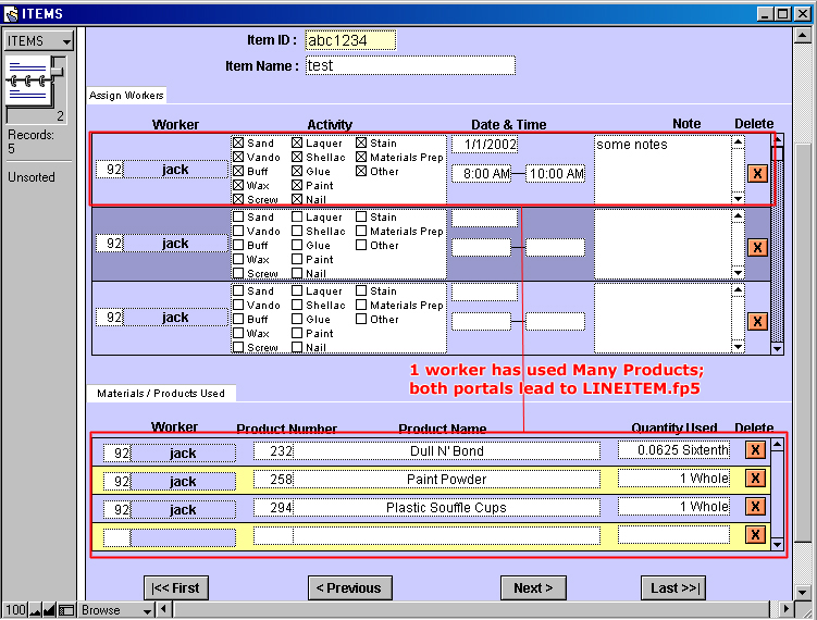

perhaps an image will help better.I have included attachement-screenshot:
but basically in portal_1 first record is OK but I would like to protect the ones below (2 in this case but could be 'many') and still be able to continue to add records in portal_1 that WILL have more than just worker_ID and Name populated.
....did I present the situtation correctly?
Hey Leb,
I don't have a clue about SQL, but I think this problem is really well solvable in Filemaker.
Maybe just add an extra field to lock / unlock editing.
Advantage is that you can simply toggle this field to the 'unlock' position if you want to correct a wrong ID or action.
