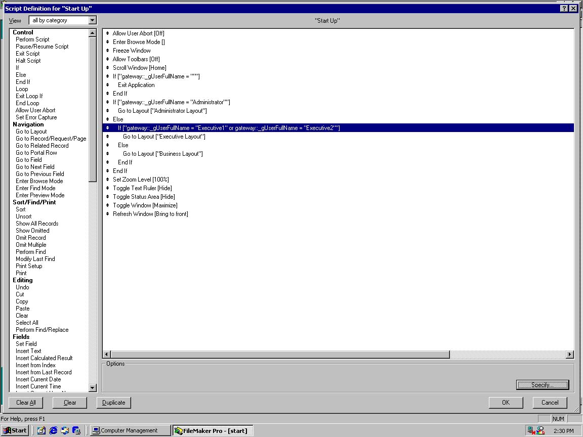

Here's a screenshot of my startup script. I use a variation of this script in pretty much all my databases.
Why freeze? I just stuck it in there because I like the idea it won't be showing the toolbars turning off or changing layouts while the solution opens.
What happens if you -temporarily- change the script to just:
Goto Layout [business layout]
