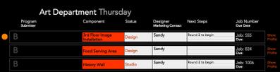

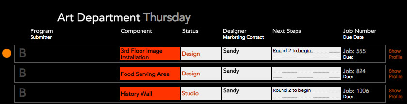

Attached you'll find a picture of the layout I'm working on (sans a few confidential bits).
In that image you'll see a yellow dot on the left. This is the effect I'm after...
When the user selects a record (there are 3 depicted) I'd like to have a dot (or arrow) appear in that small blank space to the left of the record.

Hi Andrew,
I've attached an example of activating your dot.
Ted said ... isn't there a risk that at some future point they will either consiously or perhaps unconsiously "correct their error" and remove the unintended feature
Nope. I'm not concerned, Ted. The secret to this highlight feature working (in my first examples) is based upon a standard feature of vs. 7.
The reason it works is because of the new 'Show Field Frames when Active' feature in Layouts. FM will not be discontinuing this, as it is a powerful addition; one which Developers have been requesting for quite some time (to turn off Show Field Frames). Versions prior to 7 could use this field-highlighting trick, but one must attach a script to each field (with 'Allow Entry' off on every field) and a Go To Field [] script step attached to each field. In 7, of course, none of this is necessary and that's why it excites me.
In the 'field highlight' demo, Layouts > Show Field Frames was unchecked. In this way, each field only would 'highlight' because it was set to transparent background. For the list view, this was checked so all fields for each record 'highlighted when the record itself is selected. And yes, there is a white rectangle over the red colored body. It also helps to lock this rectange - it seems to produce less flash (on Windows) than an unlocked rectangle.
A dot is another matter. I attached the script to the RecordID (pretty short on time) but you can attach it to a transparent rectangle over the entire row of fields, so any click of the record will activate the dot. I used Specify Button because the script is just a Set Field []. You can paste an arrow in this global container instead. There may be smoother ways but none are coming to me. Sorry this isn't pretty ... I've been a bit busy of late. I hope this helps you! smile.gif
