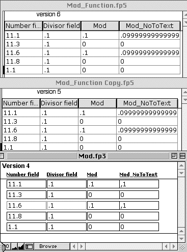

Hi Jerry,
I'm not sure what the results should be, but I created a file and there is a difference between 4 and 6. The attachment is a Screen Shot of how they look in 4, 5 and 6.
HTH
Thanks for the confirmation that i'm not crazy, Lee. (Well, i guess you didn't say that, but i'll just assume. wink.gif )
FWIW, i tested it in v7 and was not able to reproduce the error, probably because the NumToText function is no longer there, which seems to have been the crux of the problem.
Hi Jerry,
i'm not crazy
a Okie Dokie.
That was my thoughts too. Now all we need is for one of the geniuses like Ray, JT or Ugo to come along, and explain it too us in laymen's terms, why this is doing this.
BTW, I took this one step further and separated the calculation into separate fields and got the same result.
