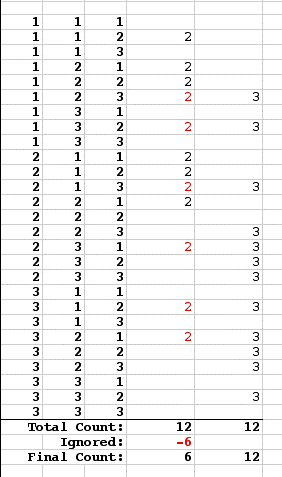

I have constructed a mini-model of the game, using only three numbers, and awarding prizes for a sequence of two. If you look at the attached truth table, it tells the whole story.
I shoud have said "you're only counting those instances where the player had a series of 1 to 6, AND there isn't another series of 6 up the road".
