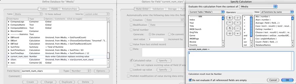

Ok again me, sorry! It did work but now it's global and all stars on all the records are the same! Ahhhh I'm freaking out, got any more ideas??
TMAS
TMAS
TMAS
The stars on all the records should not be the same.
The only thing that should be global is the "stars" container field.
Each record will have its own unique current_num_stars number fieldas well as its corresponding caluclation field, cStars. The cStars field is what you use to show the stars.

I checked out your starrating. I would like to use something similar... I have problems with the cStars, I don't get any stars in that field. How did you do that?
Britt
Hi Britt,
You place your graphics into the Stars container global repeating field.
To do so:
Place that Stars field on a layout. Select Field format (by right-clicking on field) and select for it to display repetitions 1 through 6. Then switch back to Browse mode and paste each of your graphics into the various repetitions.
Once you have everything the way you want it, you can delete the Stars field from your layout. Only bring it back if you need to change something in it. If you need to delete a graphic from a repetition, select the repetition and hit [Delete].
