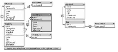

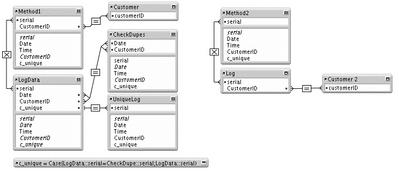

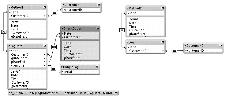

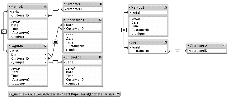

I was myself referring at 2 methods of filtering duplicates, to get a "temporary" list of unique records in a portal, without deleting any record.
See attached the graph for both methods.
Now if you wanted to clear duplicate entries, just use Method1, trigger a Go To Related Records to the UniqueLogs, Show Omitted records and delete them.
