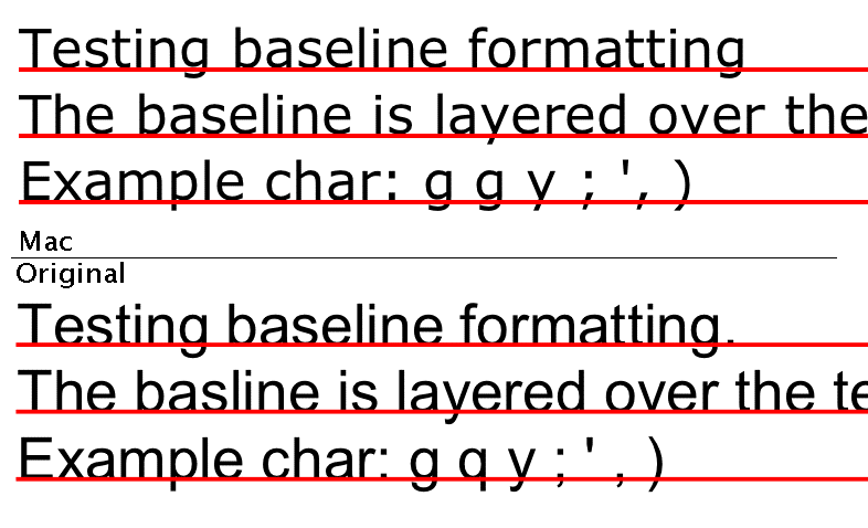

The PDF does NOT look fine here. Attached is an enlarged pic of the PDF compared to a screen shot of the file as seen on Mac. Note the "s" in "baseline" as a prime example.
Uh no, the pdf isn't fine. Comment, thank you for the enlargement; I see it now. bigglasses.gif But even zooming 400%, his file displays properly, ie, I see all of the 'S' in his file and if I copy his field to mine, it's fine there also. I can't reproduce the issue in either file.

Wait a minute. I think the issue is that the red is OVER the text (where they cross the baseline) - not just that the S's are slightly chopped. At least, upon re-reading the thread start, that's what he seems to suggest.
I get that also with his file. In fact, I spent the last four hours testing this issue because I can't reproduce that either (in MY file, ie, red baseline OVER text). But then, I can't even GET color on my baselines - only dark grey. And the baselines are always UNDER the text.
If this is indeed the issue, your Mac shows it also (baselines over text where it cross the line). But then you get color. Anyway, I have a series of test comparisons on it and there are certainly differences between the way baselines acts and colors between our systems (and I wonder if between Macs and Windoz). I consider the differences quite peculiar but I've never worked with baselines before. I want a Mac so I can always SEE what Mac Users see also - it drives me crazy on these kinds of issues.
I think it's safe to conclude that the lines being IN FRONT of the text is a "feature". However, it's much more disturbing when the lines are also positioned too high.
