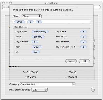

I definitely see that this works ... but I can't see the difference. One thing that I do notice is that then entire Format menu is greyed out in Browse mode. The other difference is that you have specified the format as to be left as entered. I had entered a custom format. But when I change to leave date format as entered, it doesn't do that for me ... it always goes to the format I specified in my system preferences.
How did you define your date format in the System Preferences? (I am using 10.4 in case that makes any difference.)

1. Whatever you do in Layout mode, affects only the display - not data entry. You can format the display as "Wednesday, June 22, 2005", and still, when you click into the field it will show the data as entered.
2. My Format menu is not greyed out in Browse mode. All options, except "Use System Formats" are greyed out until you click into a field. "Use System Formats" will be greyed out when file formats are the same as system formats.

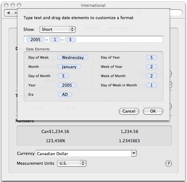

3. See attached pic.

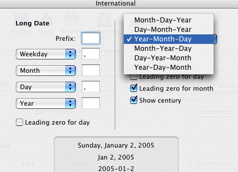

The layout of the preference is different in Tiger, but I think the information is essentially the same. See attached layout.
I think one difference between us is that in Tiger, I don't see any standard short formats. I have to customize them. I'm not sure if that is the issue ... I haven't identified a pattern yet ... but that is my suspicion.
The image you've attached is too small to see anything (try command-option-shift-4 to grab a screenshot, then save as gif). By all means, customize the format, if that's what it takes.

I rushed too fast ... I had created a tiff file (via Grab) but in my haste to convert it to a jpeg (when i discovered I couldn't attach a tiff) I did not notice I had reduced the file size so much that it was unreadable.
If you zip the file, you should not need to change its type.
That seems OK. Now, when you have it like that (2005-1-5) AND the file is set to use system's format, does it recognize entry of 2005-1-5 as Jan 5, 2005?
Yes ... it does ... but it does not seem capable of saving it with the file. But I am not sure what you mean bu recognizing 2003-1-5 as Jan 5, 2005. II have the format as yyyy/mm/dd and it displays like that, but when I click on it, it shows yyyy-mm-dd ... the same applies to any other FM date formats.
