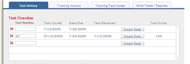

Sorry Comment! I feel stupid! :bang: My post was confusing and it turns out all I needed to do was sort (via the relationship) all the fields in the Test History table to descending and that did the trick (I then updated my calculations to reflect this).
I've attached what this part of the layout looks like (featuring the alert text)
What was happening (before I did the sort, etc) was the 'alert' text worked great (when the test wasn't received by a certain date it would alert you). However when you entered a new test to be issued it would only look at the last test received date (and not at the blank test received date for the current test that was issued).
