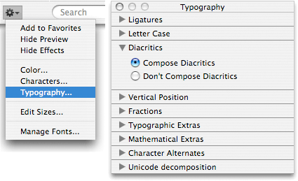

I confirmed what "themouse" is seeing, the problem is that FileMaker is "Composing Diacritics". Take the text "Sony Classical/Legacy", paste it into TextEdit, select it, then use the Font Panel to turn on/off Compose Diacritics to see the issue.

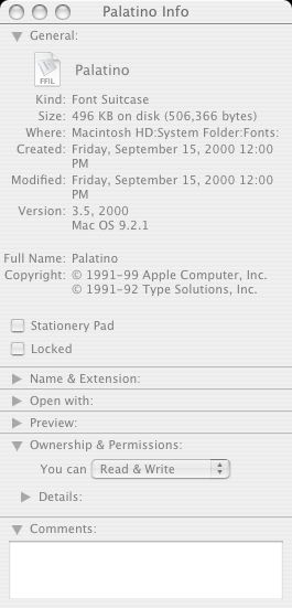

Could others have a different version of Palatino? Mine says Copyright 1991-1999 Apple Computer Inc., 1991-1992 Type Solutions, Inc., the creation/modification date is 9/24/2004. FontDoctor says the font is AOK. My main Mac did NOT have Palatino installed in Tiger, my laptop did. They both have the same apps but the laptop Tiger install is much newer...
If anyone has done a CLEAN install of Tiger lately: is Palatino standard?
That is interesting information.
Here is a screen shot of the Get Info for the Palatino I have .
I tried do the test with TextEdit, but couldn't find the [color:blue] on/off Compose Diacritics ability you spoke of. Is this a new feature in TextEdit for OS 10.4.x (Tiger).
My Palatino seems to be the same, version 3.5. Compose Diacritics is accessed from the bottom of the Font Panel in Tiger as shown in the attached pic. I googled but couldn't quickly find out whether this is new to Tiger, and I don't remember...

Following your step by step instructions, I see no change to "Sony Classical/Legacy" in TextEdit.
By "no change": do you mean you have the Diacritics sub-menu & toggle Compose on/off but it doesn't affect the /L?
Yes, just like you explained to do it.
Weird, so the issue seems to be unique to Tiger. Any others with Panther and/or Tiger: please help us verify this.
