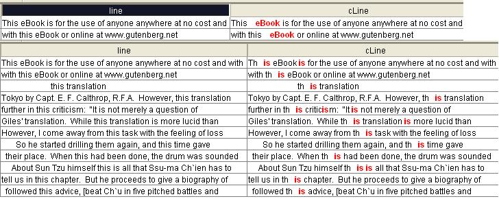

I'm using TextColor to Hilite some words in lines.
The problem is it shows them with a space-like distance from their position.
In the first example i'm replace "ebook" and in the second "is".
as you can see it doesn't look good.

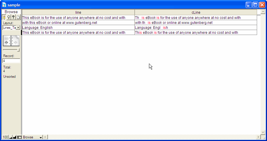

Sample file attached...
Your sample looks fine on my computer.
Note: please use .zip when attaching files - this forum does not handle .rar well.
Just to note this looks fine on my windows based machine as well.
XTrim I have replicated your problem in your file.
The problem seem to be with the data in the main text field itself (line). The calculation is fine. If I create a new record and TYPW the exact same data in the new field it formats it correctly.

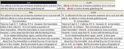

However it may have been populated; know that it is is NOT the calculation. It is the data.
Added screenshot
