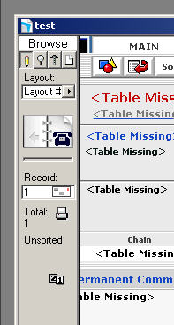

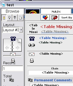

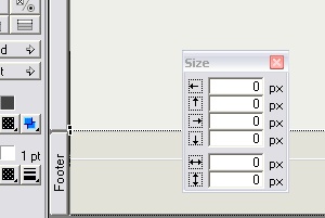

Well, I have a way of finding weird things. I've repeated tests and it does this on all my test files as well. Please notice the little black phone in photo 1. That is layout mode and the phone should be under the status area (no kidding). When I switch to Browse, photo 2 is the result. And the bugger moves around (photo3)! How I broke it: In layout mode, scroll slightly to right then enter Browse. It only does it on this one little graphic so it's not a bug. As usual, it's just me. :crazy2:
I simply ADORE strange things and weirdnesses... :jester:
And this is a new system! And yes, I made sure my display was on default and I even rebooted my system. That little black phone has been around a long time - maybe it's just time to put him out to pasture! I am NEVER bored in this business! :smile2:
Hey!!! I wonder if there is a way I can USE this information! Actually, I'd like to place other things on that Status Area! ROFLOL!
UPDATE: Nope, another graphic has popped on top also. This file has never crashed either! But I suppose it's time I get new graphics except ones I used with Approach in 1991. HAH!

Well now 5 icons jump on top of the Status Area. I hope my file isn't ruined somehow. And now I can't make it break in any other file. But it sure appears damaged to me ...
I'll set this file aside and try Maintenance on a copy of it. I KNOW it has never crashed. I watch it like a hawk to be sure I never use a file that has crashed.
Please anyone, suggestions or ideas? Has anyone had this happen? Well Maintenance didn't help. I copied the whole screen and pasted into brand new file and it does it there also!! All items on this layout are grouped and locked. Here is the same layout objects pasted into a brand new file, left grouped.
But different graphics don't do it. Now I don't know whether to trust this file or not. It has never crashed but it certainly isn't right. I can't imagine how a graphic object can overlay the status area (which isn't part of design) even if my FILE trashed out somehow!?
So it's not just my file, nor is it just the layout. These are the things I run into that make me feel insane (more than normal).

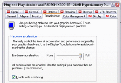

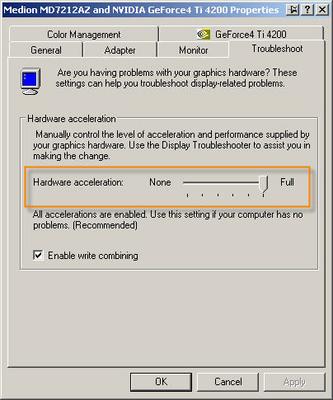

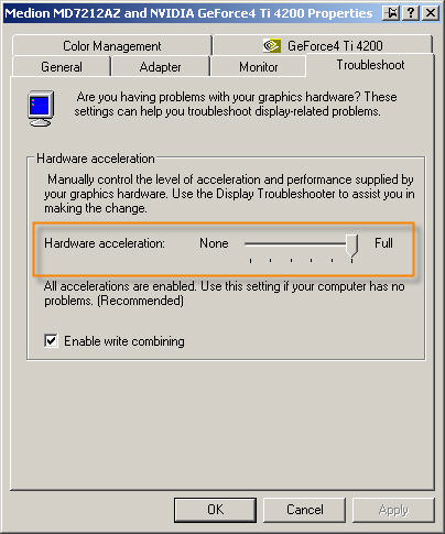

If it happens again, try this:
On your desktop, right-click and choose "properties". Choose "settings" (the last tab) and at the bottom somewhere click "Advanced". Go to the "troubleshoot" tab and slide the "hardware accelleration" all the way down. Start FM again and see if it makes any difference.
Not holding my breath but it's a good test.
I just checked. Mine is set to full already. It seemed like it might be my graphics so I checked that first. But then tested it on my other system and it did it too.
Well, it was worth a try! Thank you!
L
Maybe try it with the acceleration set to "none"?
...and slide the "hardware accelleration" all the way down.
Down. Slide it DOWN. :blush2: I was rushing a bit this morning and, like a typical User, didn't READ it right. :wink2:

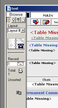

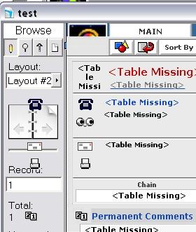

Changing slider to NONE and rebooting made no difference - neither on my home system or the other two with 8.0v2. It still does it just as in the last picture above on all 3 systems. It doesn't do it on any 7.0v3 system (and I don't have 8.0v1 so couldn't test that).
I'm attaching the test file in which it also does it in case anyone wants to try it (maybe to eliminate 8.0v1). These icons behave properly in all prior versions and it makes no sense that they would respond differently in 8.0v2 unless there is a (ummmmm, I hate this word ... bug) in 8.0v2. OR ... if 8.0v2 fixed a graphics rendering problem from 8.0v1; in which case, I won't be the only one affected. If anyone has this problem, I guess replacing the graphics would fix it; but I wonder if FileMaker should be made aware of the (potential) problem. And I wonder if it will affect other areas of a design (as in footers, etc).
Well, I'll be a good girl and tell FileMaker just in case ... :wink2:
I would be interested if this file messes up for anyone else. Drop into layout mode, scroll to the right an inch or so, then go back to Browse...
LaRetta
test.zip
It doesn't move in front of the status bar on my Mac FileMaker8 Advanced 8v02, on my WindowsXP Professional FileMaker 8 Advanced 8v02 or my installation of FileMaker Server8
Yep... does the same thing on two of my XP SP2 machines with 8.0v2. But does not show it on my Terminal Server machine running Server 2003 with 8.0v1.
TS Server is a Dell PowerEdge, XP boxes are one self-built and one Acer laptop.

I've been testing the resolution. If I decrease to 800x(whatever), all the floating icons disappear except PART of the black phone which only displayes EXACTLY in the center of the book (where that little hole is). But hey - it changed the wonky-aspect so I thought I'd mention it.
But since I must restart after each test, it's taking some time AND I have other work to finish tonight. We all run 1024 High(32-bit). And if it depends upon hardware differences, I would have no idea what we have, but they are all Dells. :wink2:

Well, I downloaded a new copy and it does it. : I, however, also found out why it didn't do it last time. I have a large screen (23") on both my Mac and XP machines. I had the database on maximize so that when I moved it under the status bar changing to browse simply caused the whole layout to jump to the right so that it was completely visible. This morning I tried it on my server that has a smaller screen and the whole layout would not fit and, yuppers, little-icons-in-status-baritis. I tried recovering the file on my mac but that made no difference. Try opening the file when the FileMaker application window is large enough so that the layout window can hold the entire layout with nothing hidden, so it can just pop to the right... no wierdness... think of that ? ??? It also does not do the little-icons-in-status-baritis thing on the mac at all.

I have a feeling this may have more to do with the graphics card on your computer than the exact version of software. Check the model-specific settings of your card (under the GeForce4 Ti4200 tab, judging by your screenshot) for anything weird.
Not sure what you mean about a window being bigger than the XP frame. I am pretty sure it happens when my application window is maximised because I have never seen an icon move. I could well be walking in my sleep and doing it but I'm pretty sure it's XP or aliens.

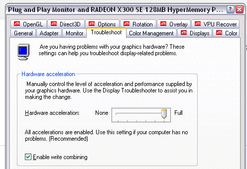

I have no such tab that I can find. But I DO have a Display settings tab in Control Panel (which itself contains 13 tabs). I'm unsure what to provide. Here are some of the settings listed - and these are the standard settings that came with the new Dell. It is an ATI. I haven't changed anything:
Normal size (96 DPI)
Adapter: Radeon X300 SE (0x5B60) 128 MB HyperMemory 75 MHZ
I also found an interesting tab which contains anti-aliasing information, called Direct3D
Anti-Aliasing set to Application Preference
Anisotropic set to Application Preference
Texture, Midmap and vertical synch set to 'Quality'
Performance set to middle
There is an OpenGL tab almost identical to the above except it's Anisotropic is set to 'Quality' instead of Application Preference. I am willing to begin tweaking each setting, restarting my system and opening my FM file again to test. But there are SO MANY different settings that I don't even know where to start. Using a Combination() function, it would probably calculate that I would need to perform several hundred tests (of each combination). Can you help me further narrow down what I should be looking for? I'm unable to convert your 'GeForce4' suggestion to Windows - or I'm just looking in the wrong place for it. Thank you for helping! :wink2:

Sorry - I was looking at Wim's screenshot by mistake (what's happenning to me lately?). That is the model of HIS graphics card. I think you should have a similar tab with the name of YOUR card. As for which parameter exactly - it could be anything, but sometimes the parameter name gives a hint.
If you have another graphics card (a different model), you could test and see if that's indeed the source of the problem.
That was a screenshot from my machine, not L's. But it seems we're using different graphics cards. Would have been too easy if it were the same ...

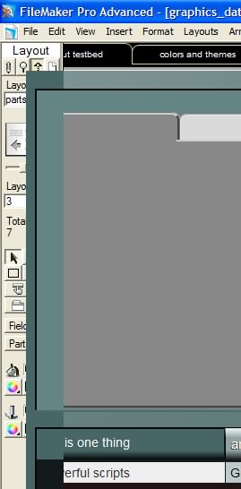

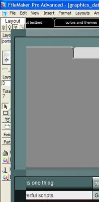

I have now caused the same problem where plain old FM rectangles and fields appear in the status bar area by using a graphics resource layout that is much too big for the display screen, it also, like your screen has lots of objects on it. I attached a couple of screen shots
Hi Ken,
Wow. Well I admit to filling my layout space to the max allowed by our monitors but FM isn't being very forgiving about it. Thanks for the additional info. I hope to test this more thoroughly this weekend. I'm going to use my same funky graphics but try moving them inwards on the layout and see if it still causes the same problem. This might narrow it down a bit. It may just be graphics unlucky enough to be placed close to the left edge? And only on SOME systems. Very bizarre ...

I've had the same problem, especially with layouts that have tabs on them. I believe it is a FM 8 problem...not Windows or hardware as my machine has not changed in 1.5 years. Why don't you submit it as a bug to FMI with all your screen shots?

My screen shots were made with current v8.02 stuff. the file is less than a month old. I also got it to work with a brand new file and a brand new set of rectangles, so I don't think it has anything to do with corruption.
