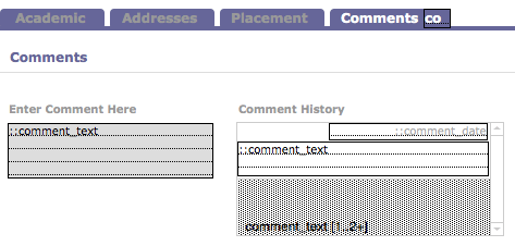

I'd like to design a comments feature which has a field for entering the text of the comment on one side of the page, with a portal on the other side of the page which displays all of the comments associated with a record (with no blank row for entry).
Here's how I envision it working - after the user types a comment into the "commentsEntry" field and clicks the submit button, the "commentsEntry" field is cleared and the comment is posted in the portal. The portal is not editable.

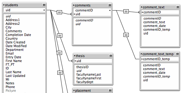

I'm thinking I need two tables - one for the entry field and another for the portal (where commentsDescription in table 2 is a lookup value from commentsEntry in table 1).

Hmm. In your example I'm not sure I understand the significance of fk_invoice_temp. Why it is configured as a calculated value and why is invoice_id = fk_invoice_temp?
Thanks again. I'm obviously new to Filemaker.
There are two auto-enter calculations...
The "real" foreign key (invoice_id) to the invoice is populated when the record is created through the lineitemscreate TO. It is given the value of fk_invoice_temp, so it will show up in the portal.
The fk_invoice_temp field is initially set by the relationship when the related record is created, but the Evaluate() function changes it to 0 right after the invoice_id field is populated, clearing the data entry fields. (since the temp key field being set to 0 means it's no longer related to the invoice record.)

Reed- I think I'm really close, but not quite there. Attached are the db schema and the (simple) layout.
I think the I'm getting tripped with the clearing of the comments entry field. When I enter a new comment, the commentID does not increment forward (it's stuck on commentID=9)
Right now the function in comment_text_temp::commentID_temp is:
Evaluate (
If ( IsEmpty (commentID);commentID_temp;0);
commentID
Per your example, comments::commentID is a serially increasing number, while comment_text::commentID=comment_text_temp::commentID.
Ideas?
