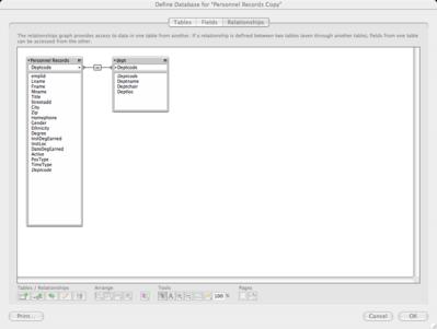

Since the People is the MANY side of the relationship, you can place your Department fields directly on the People layout. You can use regular fields (with Allow Entry in Browse unchecked) OR just place merge fields of them.

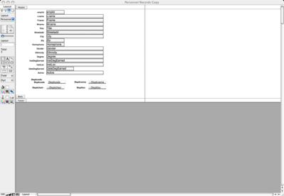

Thank you for the response. Attached please find 2 images- relationship and layout... I want to enter the Dept code (ie BHS or something) and then have the dept name, dept location, dept chair auto fill based on the relationship. I also would like to have it so the fields that appear are display only- not able to be changed.... but that would be my next step.
