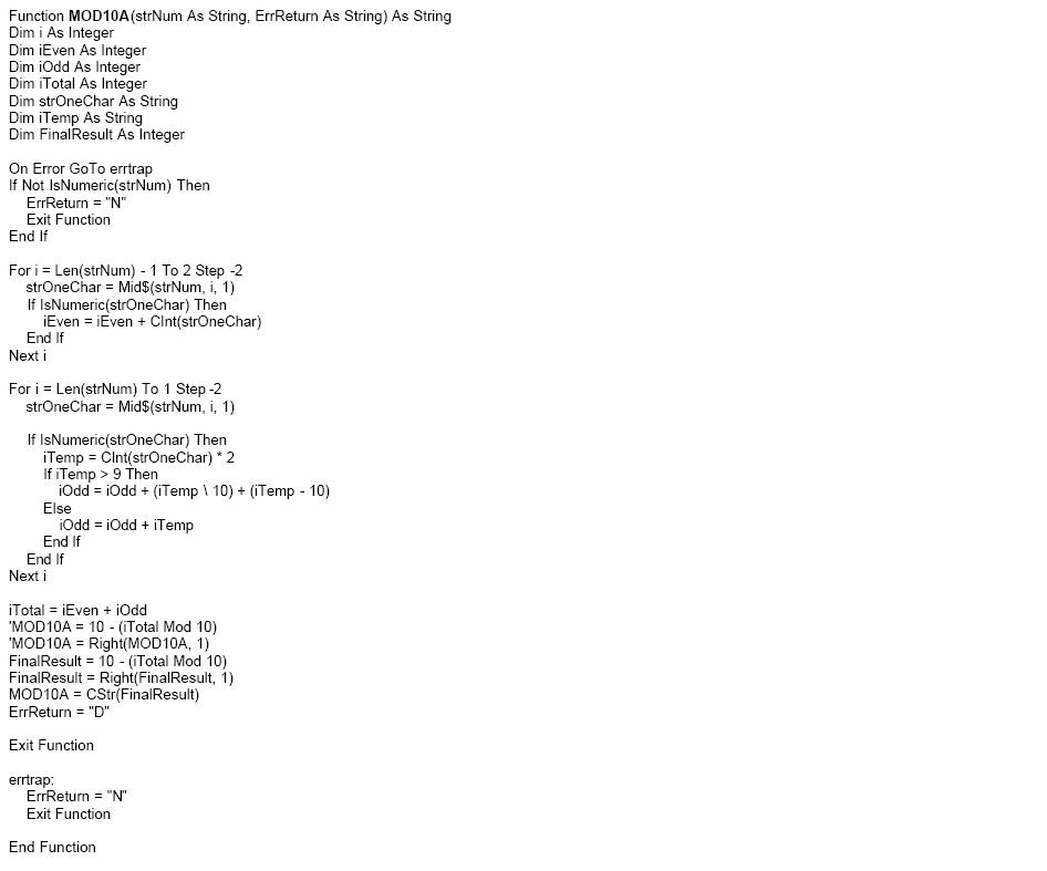

Mod10A check digit
Has anyone implemented the MOD10A into FileMaker?
If yes, how did you go about it to achieve the same results that this code would generate?
