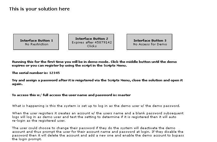

March 7, 200719 yr here is one i did a while back... it used account access to time bomb the demo. DemoBomb.fp7.zip
March 7, 200719 yr here is one i did a while back... it used account access to time bomb the demo. Hi Stephen, I have modified your gExpire field. Now your demo expires after 45879142 cliks. Ann I am sorry for my English
