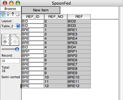

The is not strictly a serial number but i get what you are trying to achieve.
Table 1 contains 6 Records with 6 unique references
AAA
BBB
CCC
DDD
EEE
FFF
Table 2 contains line items
AAA 1
AAA 2
BBB 1
BBB 2
DDD 1
CCC 1
These are 2 fields ...
Table 1 Reference (eg: AAA)
Table 1 Reference SerialNumber (eg: 1)
1. create a relationship between the "Reference" in both table
2. For table 1 Sort the values by "Reference SerialNumber" decending
2. In table 1 create an unstored calc "Last SerialNumber" and make the result "Table 2 Reference::Reference SerialNumber"
3. "Table 1 Reference SerialNumber" can auto enter "Last SerialNumber" + 1
As I said someone would probably have a better way.

See attached
SpoonFed.fp7.zip

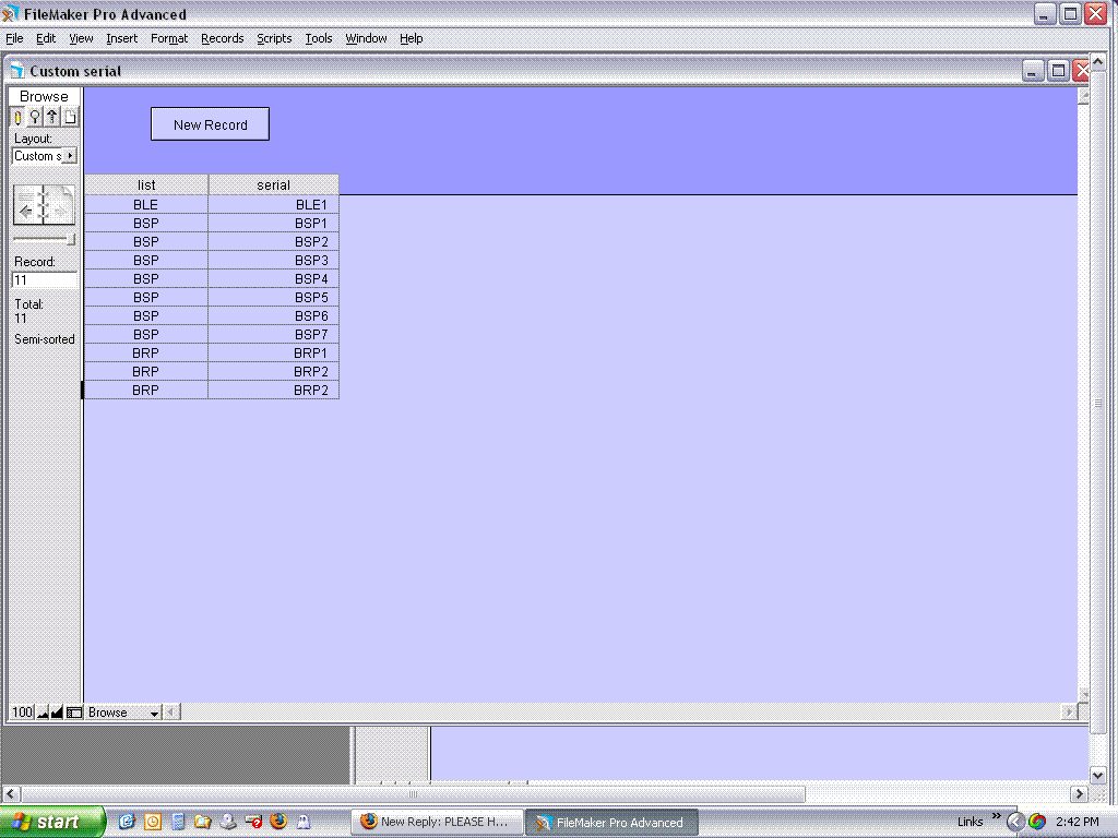

Very neat daniele :
Just so you know. I broke it by two Users creating a new record simultaneously. I wouldn't trust this over a network. All I did was leave the cursor in the field in the first window and opened a second window. Duplicate. Same situation which would happen in a networked environment. I sure liked the concept however. :wink2:
I should add that I think adding a Commit Records/Requests might prevent it. But I STILL would not trust custom serials. There have been hundreds of discussions on the issue and any time you look outside standard record serializing, to a count of records, it will break eventually.
... or try this one too ( an eventually duplicate record will have a new serial )

The stick is that the progression serial ID does not goes up to more than 10 records within the categories in the listvalue.
That simply isn't true of my example "SpoonFed.fp7".

In your file, if you delete a mid-row record in a series, e.g.
BRP2 in BRP1, BRP2, BRP3,....BRP12, and then create a new record - it wil be recreated (as BRP2 instead of BRP13) that compromises the integrity of a solution
This had been addressed in earlier posts ...
"... that is the way that custom function operates, it recovers the progression"
