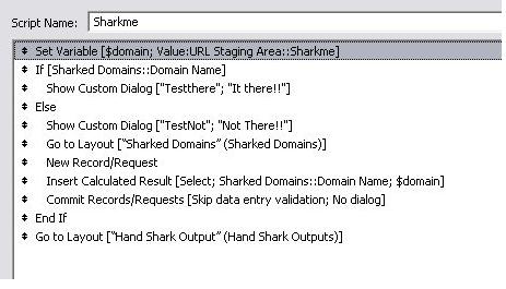

LaRetta, I tested it against both ip and text domain, seems to work fine both ways. Here is how I set up my test:

[color:green]CLARIFICATION: rayh34, your post was in Calculation Engine and you are referring to an If[] script-step. I had tested the calculation. But upon testing it in script still makes no difference. I wonder if this is a version behavior change! Script fails in 8.0v3 when no integer is in the field. So has it changed in 8.5? Did you try Comment's file? I did and the results seem to hold and he is using vs. 7 (I believe). And I tested using vs. 7.0v3 here and it also fails just as it did in 8.0v3.

Ok, Now for my script... After seeing the results of your tests, I when back and examined it closer and found that the couple of domain tests I used happen to have at least 1 number somewhere in the domain name. when I tried straight text, always false... great.. back to the drawing board!!
