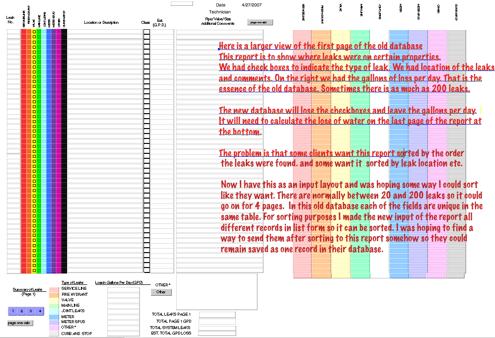

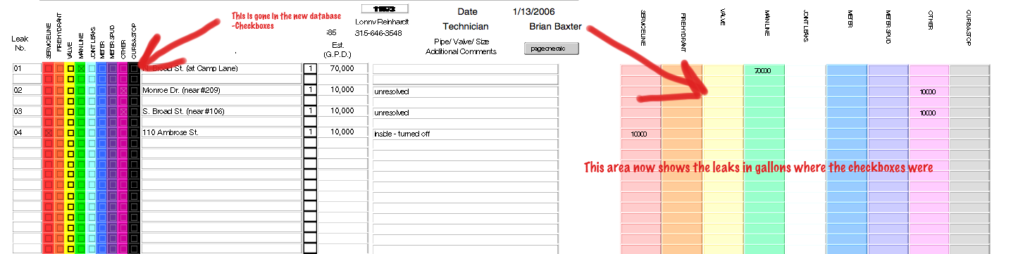

I have included screen shots from the old database. I inherited their report that they like but they just want to be able to sort it somehow. This is for a business that does leak detection on properties. They keep track of the location , type of leak and gallons per day losses. There are between 1 and 200 leak locations and with their header and the footer it can be as long as 4 pages. I have written over the old report in the graphics I am attaching here so you can see what I am trying to loose in the old database. The old file has like 2000 fields in one record. so it never could be sorted. I have a new database with an imput layout that is in list form . this will hold all the leak information I need and then they can do a job number and I can isolate the records for a certain job. These could then be sorted by location, by highest leak , or whatever and this would need to flow into this report like I am showing you. Then this report would be saved as one record. I am including the graphics in this post.

I appreciate the help very much. I am grateful for all of it. However, my client wants the look but not the buttons and the list but be able to sort. I do not have a file I can show you except the screenshots because the old database was extremely tied to thousands of scripts.
Now I am at this point. I have an understanding of a table and a list form. I see that the table sorts as I would like then I return to the list and it is right. I am not sure there is any way to script going from list view to table view. I would hope so. The trailing grand summary can work with a list view. As SOON as I have something I am not embarrassed by I will put it up. Thanks Again
