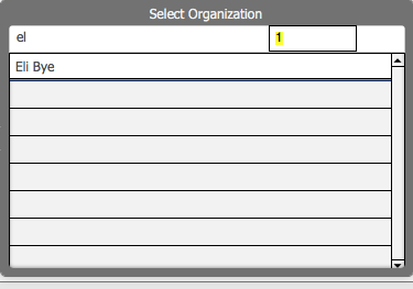

In March Soliant Consulting published Sara Severson's excellent script for dynamically filtering portal results as users type into a global field:
http://www.soliantconsulting.com/blog/2013/03/dynamically-filtering-filtered-portals
I too had the impulse to display a count of the results, and added two lines to her script to set $$Filtered_Portal_Count as the filter is updated:
Between Sara's two lines:
Set Field by Name [$field ; Evaluate ($field)] // Refresh portal without flicker
Go to Object [Object Name: $filter] // Return to global filter field
I inserted:
Go to Portal Row [Last] // washed away by Sara's next line
Set Variable [$$Filtered_Portal_Count; Value:Get ( ActivePortalRowNumber )]
