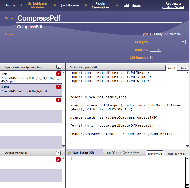

March 16, 201610 yr Hello, I found that discussion as I'm looking for a script compressing a pdf file generated by the plugin printswitch of myFMbutler. An A4 without only a little picture (logo of the society) has more than 300ko ! In the scriptmaster sample file, after adding the iText library in jars, I pasted the script of nleon307 ; it runs without error but the dest file has the same weight Can you give me an indication or a sample file ? Regards Noël
March 16, 201610 yr Noel if you read the comments further up, the compression is like zip, but it does not resample any images in the process. For that you need some of the other techniques. Can you post an example of the file?
