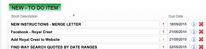

• When I make a new entry into a portal, the cursor automatically enters a text field.
• This text field triggers a script. (or whenever I enter it)
• I had hoped that script would set a variable called "$$todo", with the value being the record's Primary Key, which i had thought it would have grabbed with the following script...
        Set Variable [$$todo; Value:GetField ( ToDo_Pk )]
• But I just get a "?"
So in other words, I'm trying to set a variable called "$$todo"... of the record that holds within it a text field I had entered. Obviously there is something wrong with my script, but I haven't got a clue what I'm doing wrong... is there anyone out there who can point me in the right direction?

Set Variable [$$todo; Value:ToDo::ToDo_Pk
I've added a merged variable to my layout to see if it is pulling the value as I haven't got 'Filemaker Pro Advanced"... and it is just showing a question mark. Additionally other items that are looking to that variable to act aren't working.
The trigger works off... "OnObjectEnter" which I should have thought would have fired when I click into the text field?

The portal is within a 'Tab Control', Now when I click on another tab and then return... the variable loads the right value. I added "commit record" to the script but then I couldn't edit the text field as it instantly committed, moving me to the next field.
I got it to work by using... GetValue
So its working, now I've just got to force it to work without having to leave the tab for another, then return.
I tried adding a link to an image on my google drive again, but it is hopeless... just get a spinning icon. But I here is a link to it on my drive...
https://drive.google.com/file/d/0B687aT8LAHKmbzRIaVNReVRENnM/view?usp=sharing
Where the "4" is, is where I added the merged variable <<$$todo>>

That does not tell me much, it is in Browse mode...
​I've added a merged variable to my layout to see if it is pulling the value as I haven't got 'Filemaker Pro Advanced"
​That's not a good method of testing, because the layout may or (more likely) may not be refreshed . To make sure your script sets the variable correctly, have it show it to you in a custom dialog or set a field to the variable's value.
​Now when I click on another tab and then return... the variable loads the right value.
​That's just one more indication that the real problem is with the layout object, not with the script.
