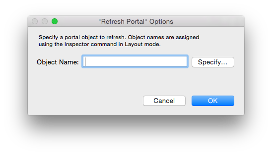

It also raises another question: with 'Refresh Portal' does FM act on the current portal (which puts the obligation on the developer to move the focus there) or do you specify an object name (which requires the developer to name the portal)? Or.. is there some new way to specify the target portal (e.g. a popup, etc)?
And the docs state:
• If the layout object specified for Object Name is not a portal, Refresh Portal performs the Refresh Object script step.
So again, why does this need to be a new script step? Why not update the existing 'Refresh Object'? If the passed object name is a portal, it refreshes the entire portal (ignoring the optional repetition param), otherwise it behaves at it did in the past.
