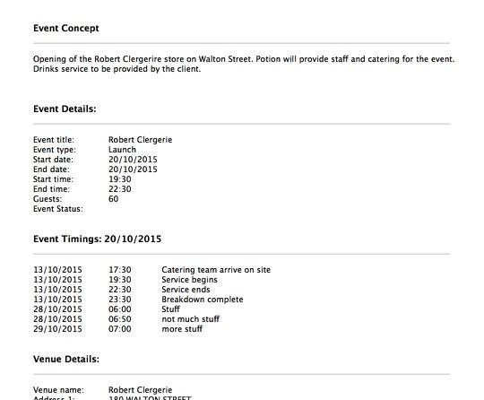

It's only being displayed on a layout for print (screenshot attached) but the fields showing are only shown if relevant which is why I think it was set up the way it was. Here's the calculation which pulls it all together (there's other ones as well for other printed pages which all run on from each other):

Good grief.
Again, I ask, why not simply use a portal for your new need.  I'll skip further comments on the existing 'report' calculation.
