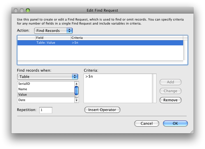

On 12/12/2015 at 8:58 PM, Josh Ormond said:
You can't use operators with the variable. It can only be the variable itself.
That's not entirely true. For example, this is a valid request ($n contains a numeric value):
req.png.7addca233c01c7728005bd31dafaf201
Thank you for the correction. That does indeed work. I know there are somethings that you can't do with variables. For example, the between operator ( "..." ) doesn't work with variables.
Well, yes and no. This works:
10…$n
and this doesn't:
$n…20
As you can see, I don't use the Perform Find [Restore] step often.
