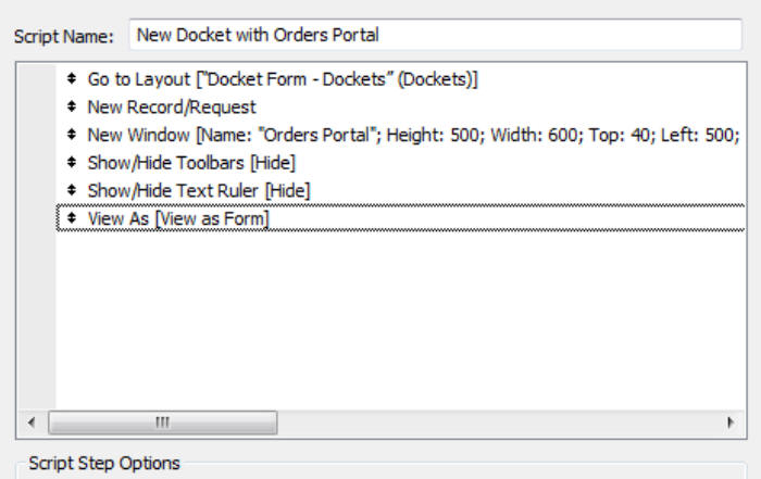

I want a second floating window to open next to my "regular" window when I change to layout DocketForm and request a new record.  .  My script for this seems to work well enough to have both windows visible.  I am using FileMaker 12 Advance on Windows 7.  This is the script:
Got to Layout ["DocketForm (Dockets)]
New Record/Request
New Window [Name:"OrdersPortal"; Height: 500; Width: 600; Top: 40; Left:500
Show/Hide Toolbars [Hide]
View As [View as Form]
The only problem with this part is that the new window appears immediately and the main layout window does not change to new layout (DocketForm) for an unacceptable period of time.

Regarding the slow display of the main layout when I run the first script that goes to the DocketForm and creates a second floating window.
I run the script from a button on the Orders screen. I want that layout to be replaced with the DocketForm and a new record/request.  Also, I want a second floating window to appear.
What happens is that the "main" layout showing Orders remains on screen. The "second" new floating window appears immediately in its correct position on the side of the screen. i timed it and it was 15 seconds before the "main" layout changed from Orders to DocketForm.
The second window appears immediately, so those script steps are finished quickly. Script Debugger shows a red tag on the New Record/Request but I don't know how to use it to find what the error is.
I think I am asking FileMaker to go to a Dockets screen and create a new record in the Dockets table. What am I missing?
The little red tag is a break point, which is set by you - you may have clicked just left of the script step in the past. You can click on it to remove it
Can you screenshot your script? 15 seconds to change a layout seems excessive...
Edited by webko
I have attached a screenshot of my script.
Thanks for telling me about the red tag.  I've written a number of scripts but, fortunately, haven't had to use the Script Debugger until now.
Yes, 15 seconds is quite excessive.  Couldn't believe it when I timed it!
any script triggers on those layouts?
No, there are no script triggers on any of the layouts. Just a button to activate my problem script that takes so long. That one is on a different layout that begins with the GoTo script command that takes me to the layout that loads so slowly (DocketForm). The only script on the DocketForm at this time is activated by a button on the DocketForm that has a GoTo Layout command to the originating layout.
