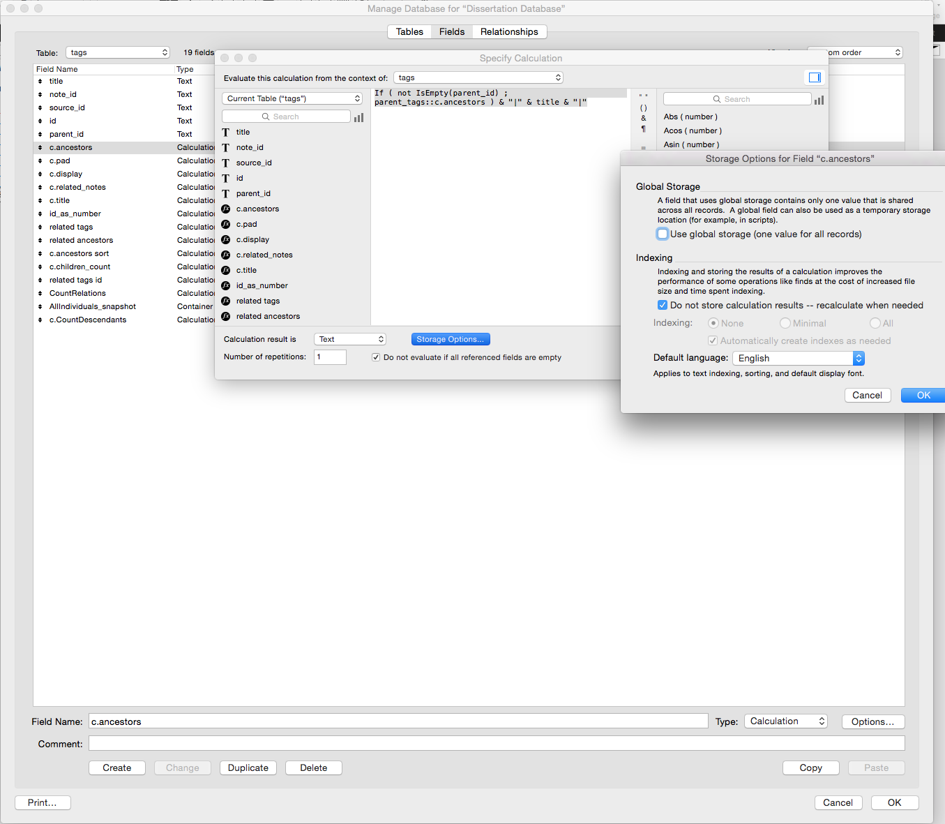

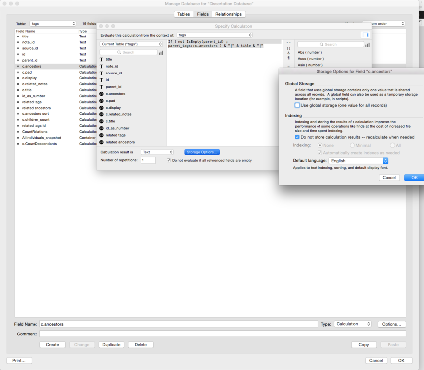

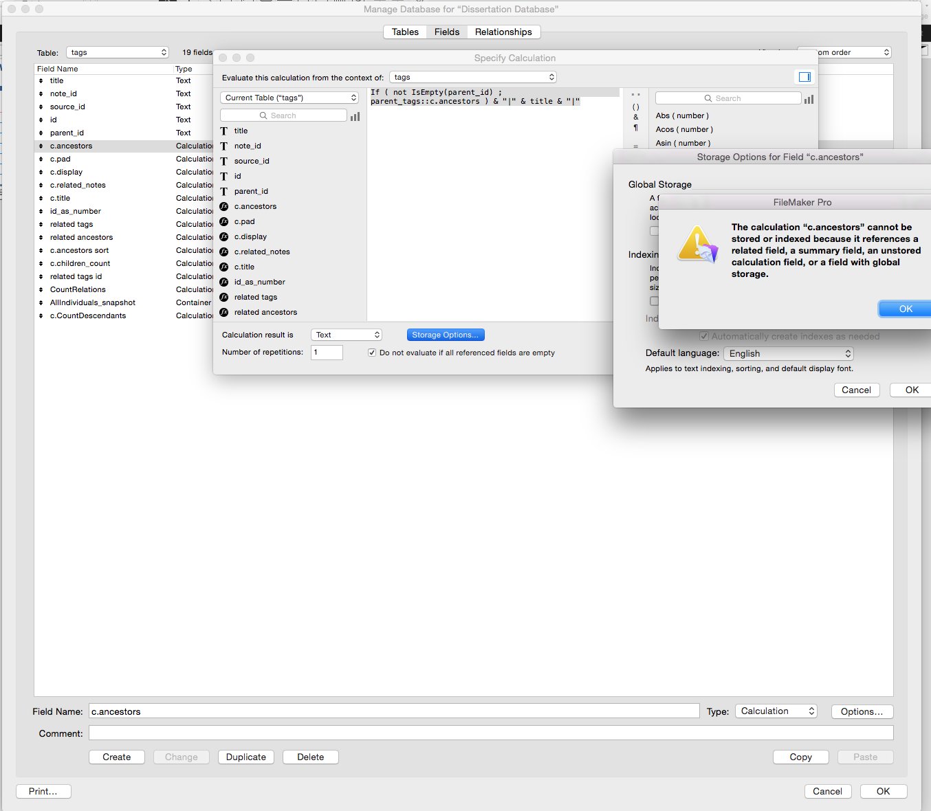

Update: I've corresponded with FM Support, who directed me to some documentation on auto-complete (http://help.filemaker.com/app/answers/detail/a_id/5437/~/filemakers-auto-complete-feature/track/AvPJxwpRDv8S~depGmIc~yJf1ssqMi75Mv86~zj~PP~z). Most of it I already knew and does not appear relevant. However, I saw one note regarding indexing, and I wonder if that's the problem?
 As you can see in the attached screenshots, the field in question is not and cannot be indexed. In FMP 11 the field is set up the same way--no global storage, no indexing--and it works fine. Perhaps this is a new constraint found in FMP14? Any thoughts?
Thank you!
