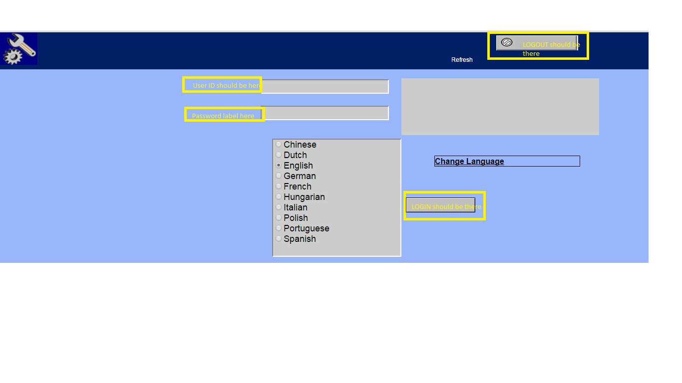

Actually in external file i am accessing Labels for my application so when i open file from IWP, those labels not showed/disappered. but when i redeply database from server, it stats work for some time duration like 2-4 hrs.
Please suggest, if you have any thing in your mind and i am missing.
Attaching actual picture that works when we have no problem in loading of external file . Fortunatly today just after 5 minutes, it starts work perfect without anythingd doing.

Hi All,
After a long time I faced a issue on IWP which I have never come before.
The issue is that, we have three files hosted on server as IWP.
Name of files: A.fmp12, B.fmp12, and language.fmp12.
In file, A and B, there is not a single lebel defined, all the lebels are coming from language file.
Just by using a relationship, we are selecting the language and the lebel comes as per the selection.
But sometimes, lebel becomes invisible. only page is visible without a single lebel.
Most of the times, it is working fine. It is happening with both the files.
System Details: FileMaker Server v 12.0.5.551 for Windows Server 2008 Enterprise
Please suggest to resolve this issue. Thanks in advance.
