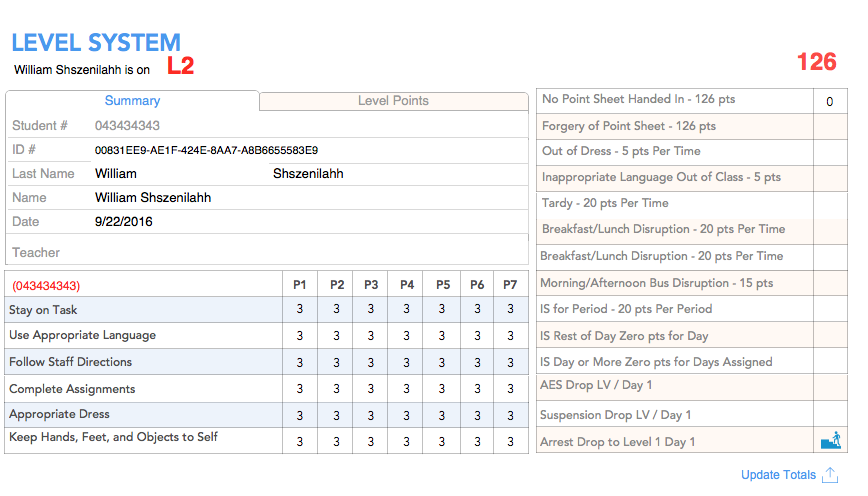

Long story short, I currently work for a school that is using a level system for students(level 1-5). For example students start each day with 126 points, depending on their behaviors the students will have points taken away from them. To get to level 2 the student needs to have at least 85 points per day for 5 days no matter if the days were consecutive or not. And to get to level 3 they need to get 95 points per day in 10 days. Now the issue i am having, lets say the student is on level 3, He is on day 30. Now the student messes up and gets level reduced to level 2. What I am trying to do is keep the data from what the student did to get to level 3 but at the same time if we drop the student down to level 2. The count will start from level 2 day 1 etc etc until they reach level 3 based on points on a certain amount of days. I would like to keep the past records and at the same time if a student does drop down a level keep that data from the previous level he was on and he starts over fresh from level 2 till he hits level 3 again. I need help with finding a code/script to do this I have been trying to do this for some time. I have the first part of them going up and down levels but need the code to save the old data of a students level and continue on a new level and if he goes down again it keeps the data again and restarts again on a previous level.

Each day's point sheet should be in a separate Point Sheet table related to Students by Student#. In addition to all of the lost points in the right-hand chart, this table  should have a starting level field (for that day), a Days at Current Level field, and a Move to Level field.
The script to populate the Move to Level field would look something like
 Set Field [ Move to Level; Case(
     not isEmpty(AES Drop) or not isEmpty(Suspension Drop) or not isEmpty(Arrest Drop); starting level - 1;
     Days at Current Level ≥ {defined value}; starting level + 1;
 From the relationship you can find the latest Move to Level record, and use it in a script to count the days since the change to the current level to populate Days at Current Level, and thereby calculate an upward Move to Level if warranted.  You will also have the means to report all level changes for any time period.
The starting level field can have an auto calculation:
Let(
[~lastLevel = GetNthRecord( starting level; Get(Record Number) - 1);
~lastMove = GetNthRecord( Move to Level; Get(Record Number) - 1)
Case(
     isEmpty(~lastMove); ~lastLevel;
     ~lastMove)

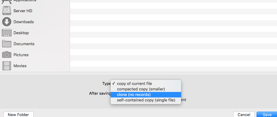

Why not attach a copy of your file, remember to remove any confidential information or save a No Record copy.

Why? that the important stuff, it’s the client names, address, etc. that is the confidential information that needs to be removed. I removed your file above because it has student information in it.
Look at the Save options, there is a “Save a copy as....select that and choose
