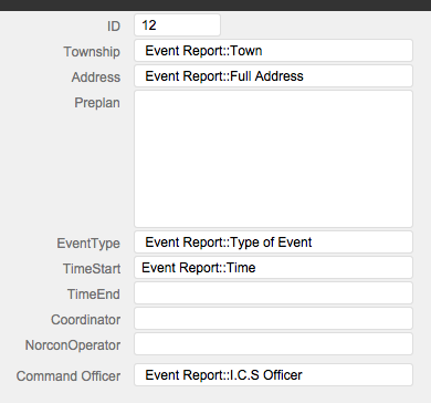

February 27, 20179 yr Hi, I have searched everywhere and could not find something I could apply to do what I am looking for. I have a Fire Dept database that I manage, they have a table of "Event Reports" for each call. Within our Fire Departments we have 14 towns that are part of a Mutual Aid Group which has a radio desk that manages large, multi resource incidents. I would like to develop a database to help them manage the resources at the incidents since a handful of departments are already using the database solution I host for them on a server. I would like to create a script that copies the values in about 6 fields on an Event Report from a townships database and have a new record created in the Mutual Aid database and have those 6 values set into their respective fields? I understand the set variable and set field steps but spanning those from one file to another is not something I have done before. Any help would be really appreciated. Town Database the data is coming from. Event Report:Time Event Report:Type of Event Event Report:Full Address Event Report:Township Evnet Report:I.C.S. Officer Mutual Aid Database the data is going to. Incidents:Township Incidents:Address Incidents:TimeStart Incidents:EventType Incidents:CommandOfficer Edited February 27, 20179 yr by CKonash

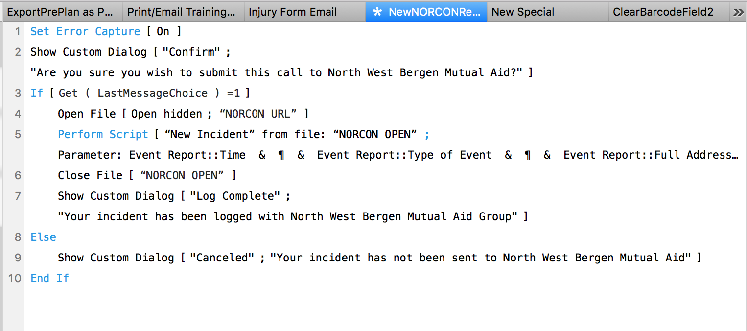

February 27, 20179 yr Hi there If I were doing this, I would Perform a Script that exists in the Mutual Aid database, from the Townships database, and pass the information as a Script parameter, separated by carriage returns. So in the Townships database you do something like :- Perform Script (External Database: Mutual Aid DB ; Add Record Script ; ScriptParameter "Time¶Type Of Event¶Full Address¶Township¶ICS Officer ") and then in the Mutual Aid DB, you would have a script like this :- Add Record Script Go To Layout (Data Entry) New Record/Request Set Field ( Township ; GetValue ( Get ( ScriptParameter ) ; 4 ) ) Set Field ( Address ; GetValue ( Get ( ScriptParameter ) ; 3 ) ) Set Field ( Time Start ; GetValue ( Get ( ScriptParameter ) ; 1 ) ) etc This should give you a new record with all the data copied across. Does that help? Edited February 27, 20179 yr by rwoods

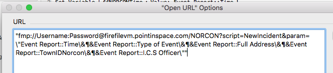

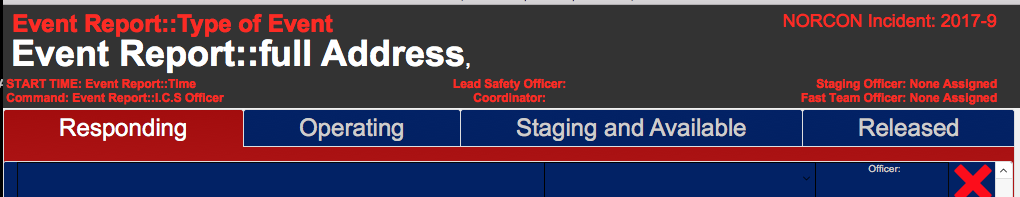

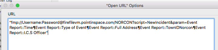

May 15, 20179 yr Author 20 hours ago, Wim Decorte said: Here's a good intro on the fmp protocol. Also look in the help for 'fmp protocol' https://www.seedcode.com/fmp-url-protocol-filemaker-testing/ Hello, I am definitely not an expert on the filemaker scripting of open file vs open URL but your direction in assisting me to find the needed reading material was awesome, thank you so much. I have never done the XML data exchange so I wouldn't know how to even start that process... Using the Open URL script step, I messed around with it this morning and am able to get the File 1 to open File 2 with the embedded user and password and also get the intended script to run. Adding in the script parameter into the URL is where I get hung up. I added the info as it appears below in the picture but it does not return the data from File 1, it simply returns the literal text that is in the script parameter of the open URL script parameter. Instead of pulling the address from File 1 into File 2 using the script parameter within the url it is only pulling the table::field. Am i doing something totally wrong? Thanks Chris
May 15, 20179 yr Should be ... ¶m=" & Event Report::Time & ¶ & etc. To make it more readable you could put your fields into a variable first.

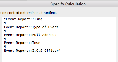

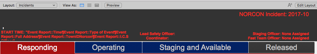

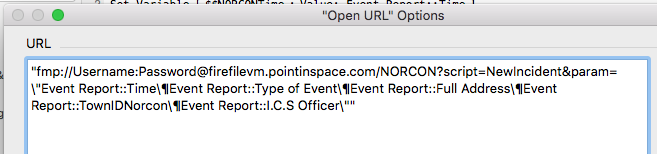

May 15, 20179 yr Author 1 hour ago, Fitch said: Should be ... ¶m=" & Event Report::Time & ¶ & etc. To make it more readable you could put your fields into a variable first. I have tried a few different variations of what you described and none of them return we I would have hoped. All of the data is entered into the first script paramenter field and it is still the name of the Table:Field from File 1. See attached. Any ideas? Thanks Chris Edited May 15, 20179 yr by CKonash
May 15, 20179 yr I guess I wasn't clear. FileMaker treats everything inside a pair of quotes as a literal string of text. I.e., your URL as written is not sending the values of the fields, it's sending the names of the fields. What I was trying to say is that your URL should look like: "fmp:// ... param=" // no more quote marks after this & // concatenate the line above with the line below List( fieldA; fieldB; etc ) // no quotes Be aware that sending position-based parameters may require extra error handling -- what if one of the fields is empty? What if address has two lines? GetValue( param ; 2 ) may not be what's expected.
May 15, 20179 yr Author Just want to say thank you so very much to the three of you that helped me. I was able to decipher what you shared with me and implement it into our fire departments database and now we can create a record and use the scrip parameter to dump in the vital info into a different database that our county will use to monitor incoming fire apparatus. I definitely could not have done that without you. Thanks so much! Edited May 15, 20179 yr by CKonash
