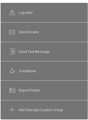

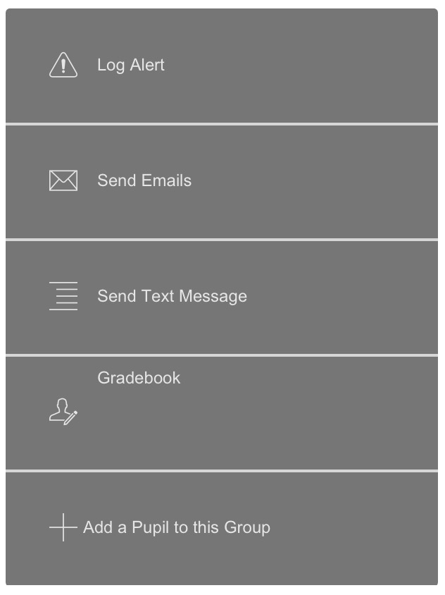

February 9, 20179 yr Hi, Got a real strange issue.... My button bars look fine, slightly offset, but fine on the desktop version... But as soon as I look on FM Go, one of the text boxes just floats away? - I have tried moving it around and changing the size and i just get the same issue but with different buttons? See images... Thanks
March 20, 20179 yr Author Has anyone had any issues in the past with button bars not looking right on FMGo? For some reason, they always seem to have random spacing between the button and the outer line? Any ideas/tricks? Edited March 20, 20179 yr by liamob1
May 5, 20178 yr Hi, Check your active state condition on the segments, matches the inactive state, the only time I have seen this occur with individual button segments is when its active and the active state has a different padding. -- Orlando
