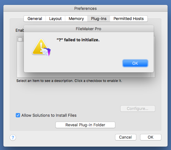

I am experiencing issues loading the ScriptMaster 5.05 plugin on OS X 10.12 Sierra using
FileMaker Pro 15 Advanced. I get the "?" Failed to initialize. error when trying to enable
the plugin within FileMaker. I have tried manually replacing the plugins 1.8.0_121
resource files and have tried the workaround suggested on the ScriptMaster site without success. Any
suggestion on what my next step that I could try? Does anyone have this successfully working?
Thank you in advance for any help.

Hey Anthony,
  Could you reproduce this error and then immediately send us your logs? Here's a link to documentation that walks you through retrieving logs if that's helpful:  http://docs.360works.com/index.php/Plugin_log_files
  Please forward those logs to [email protected], which will generate a support ticket and allow us to communicate back and forth with you. If you want, feel free to give me a call if you are available to screenshare and we can troubleshoot on the spot.

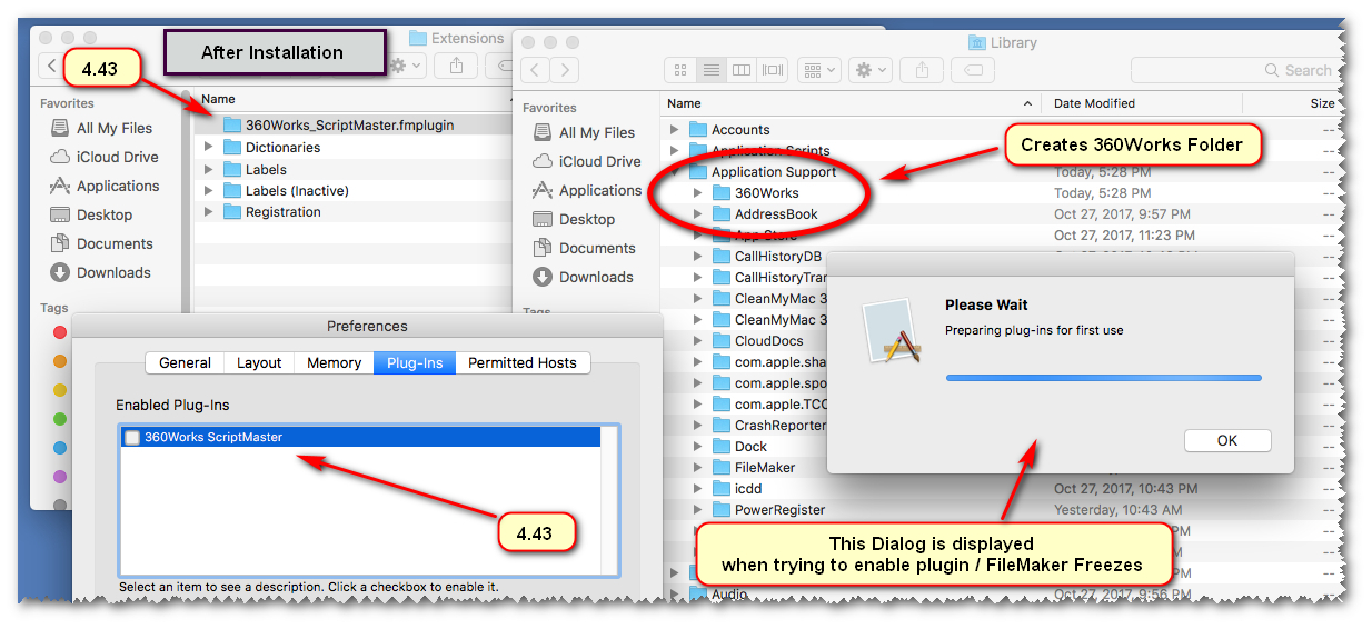

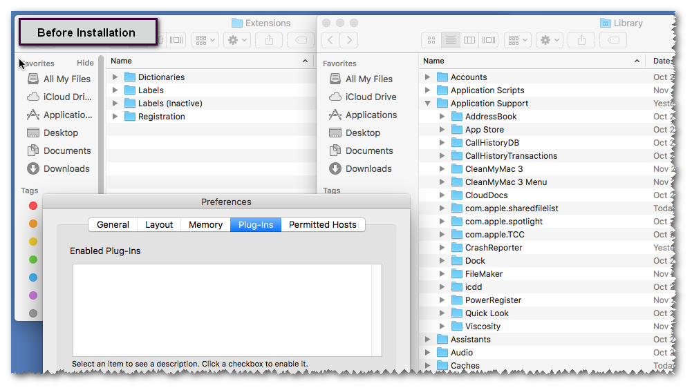

Please see the following.
Hi AnothyDixon,
As Junior mentioned, ScriptMaster 4.43 will not download the resource files as that mechanism did not exist in the framework 4.43 is based on. ScriptMaster 4.43 requires that you install Legacy Java 6 in order to operate on a Mac. That can be downloaded here if you do not already have it installed. Since you are still seeing the "preparing for first use" window,  I suspect you either have another one of our plugins installed or you have 5.05 installed elsewhere. There are 3 locations that plugins can be installed in order to use them in FileMaker Pro. On Mac with FM 15 these locations are  /Applications/FileMaker Pro 15 Advanced/Extensions/ , /Users/USERNAME/Library/Application Support/FileMaker/Extensions ,  and /Users/USERNAME/Library/Application Support/FileMaker/FileMaker Pro Advanced/15.0/Extensions . In the last two paths the "Library" folder is a hidden folder by default so you may need to unhide it or use the "go to folder" option in Finder to get to that folder. Check all of those locations for other instances of our plugins and remove them if they exist. Additionally, make sure that the plugin file that you are installing is in fact 4.43 and not 5.05 by mistake.

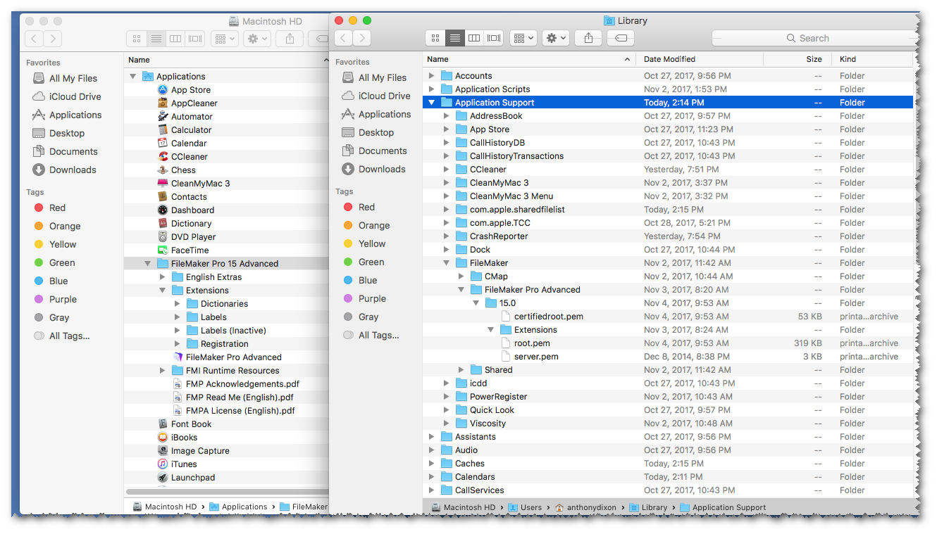

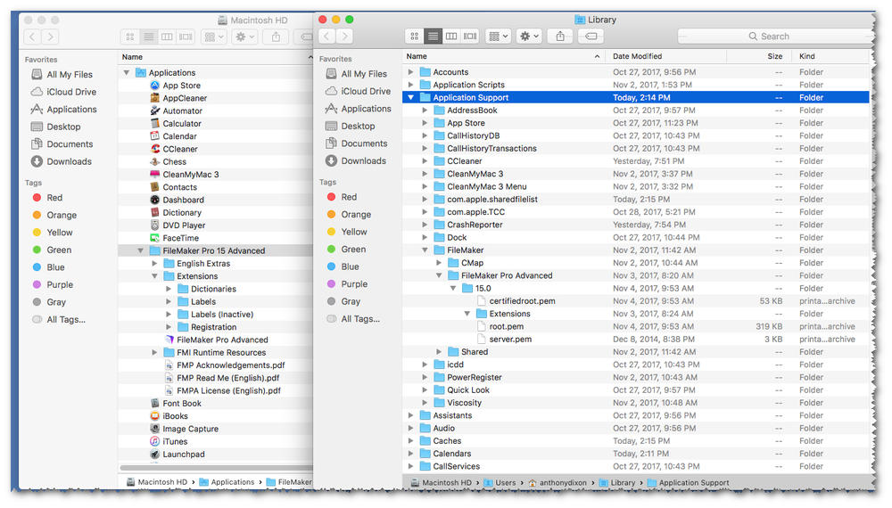

I have verified all three locations, and there is nothing installed. I can launch FileMaker and nothing happens on startup, I can verify that there are no other plugins installed by going to plugins in FM
preferences. As soon as I quit FM and drag the 4.43 extension I download from the provided link to one of the three locations and reopen FM and try to initialize it in preferences I get the first use dialog I click OK and FM freezes. The legacy version of Java had previously been installed.

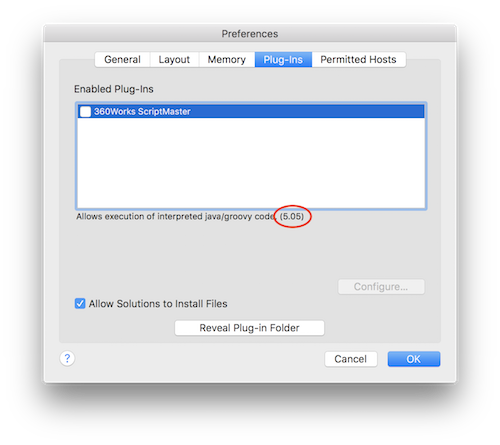

The only explanation for the "first use" window showing when you click to enable the plugin is that 5.05 is actually installed instead of 4.43. Can you confirm that 4.43 is installed? You can do so by opening Preferences->plugins and selecting the plugin. The version will show at the bottom of the window after the description. See attached screen shot.

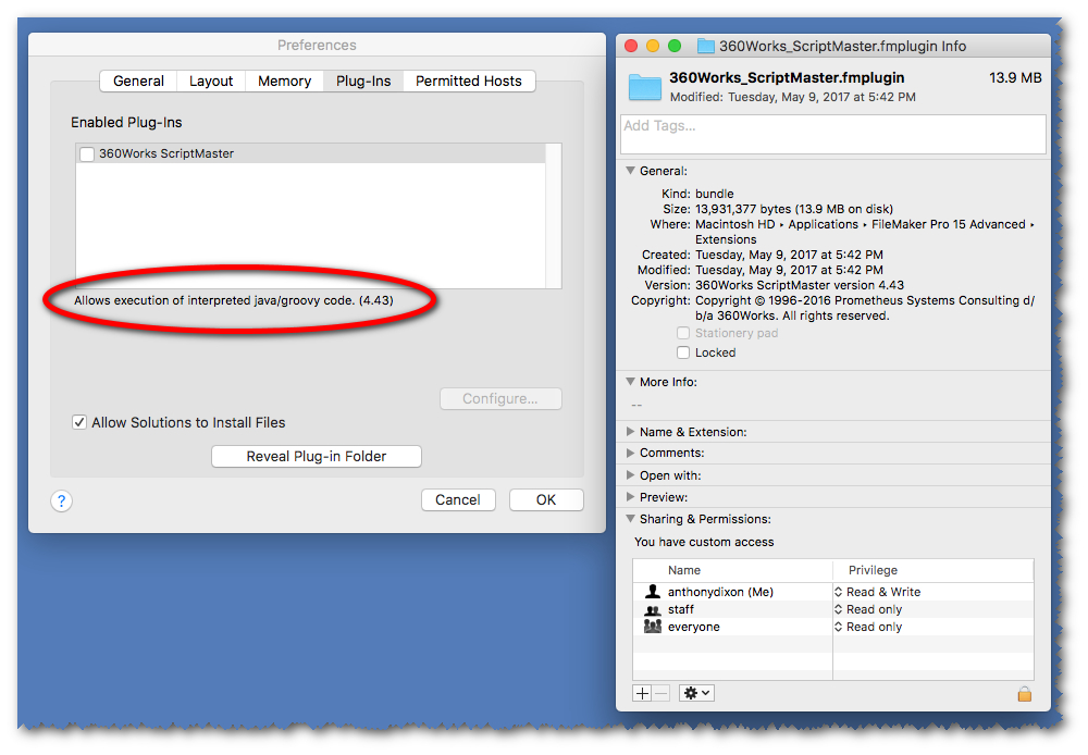

See attached.
Odd, I'd like to take a look to see if I can determine what is happening. Please send an email to me, [email protected], so we can set up a time to do a quick screen share.
Anthony,
Apologies for the confusion, it seems the instance of the plugin that is at that link  is not actually ScriptMaster 4.43 but rather a build based on our new framework and the version was never upped. Please download ScriptMaster 4.43 here.
