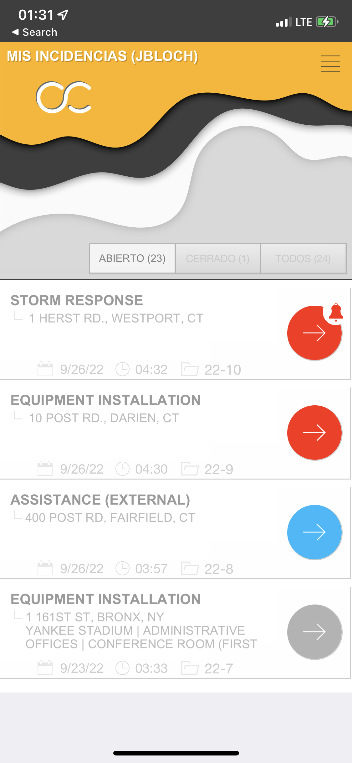

Here’s a quick and dirty look at what I’m doing.
I actually just ran into a reason why a script trigger is ineffective for me. In the attached video (above), I'm working with a single record therefore easily accomplished with a script. Now though, I need to present multiple records, each with the same info, through a portal.
