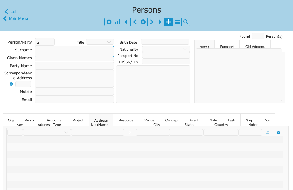

Why won't FM allow me to alter the padding settings in Tab Control?
I duplicated a d/b and changed the Style from Sophisticated to Apex Blue.  Then I adjusted the font settings from Arial 16 back to Verdana 11 as in Sophisticated.  That worked perfectly except that the tab sizes on tab control remain big enough to accommodate Arial 16 which messes up my whole layout design.
When I double click on the tab control, it shows the padding settings but won't let me change the top or bottom numbers.  Why not?
I am having a hard time figuring out what you refer to. When you double-click a tab control, the Tab Control Setup window opens, allowing you to specify tab names, tab justification and the front tab. There are no padding settings in this window.
When a tab control is selected (not double-clicked), you can adjust padding in the Appearance/Advanced Graphics area of the Inspector. AFAICT, these settings are individual to each tab, and you need to select a tab before you can adjust them. However, I doubt that will help with the problem you describe, because:
I am equally puzzled by this statement:
That is not what I experience. When I change the font size, all tabs are automatically adjusted, both for width and for height.
