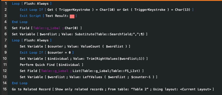

Quickfinds aren't stackable as fm-requests are, but you could then loop you through each found set and gather recordIDs in a global, and then finally GTRR(FS) based on the collection af matching IDs.
I have made tabbing out as well as typing <return> in the search field, triaging the search:
Brilliant! Thank you, Søren, for the info and the file! Makes it so much easier knowing where I went wrong. I see what you've done there and where I got confused is the connection between the Table and Table 2 occurrence. I had it pointed elsewhere. It all seems so easy in the end. There's one thing I can't seem to get going. I already had a file with several records and when I do a Search, I don't get a result. I do if I create new records after the latest script was added. Anyway around that and not have me re-enter all of the info from the previous records? Thanks again!

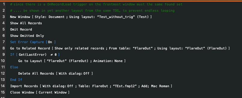

It should be pretty simple to prevent both record locking as well as personalize the highlighting with just these scriptsteps trigged from an OnRecordLoad trigger because we already have the repeater to import from:
...the portal can be cut into pieces, and be scattered out over the layout, as if it was the original field....
Edited by Søren Dyhr
